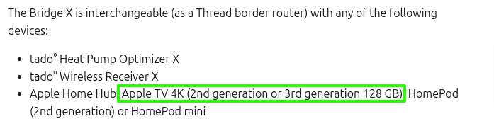

How do I figure out, if my thread router supports it? In my case an Apple TV 4K Gen2.
If it’s on the list with interchangeable bridges (which also support NAT64), which in your case it is.
Great, thanks a lot!
