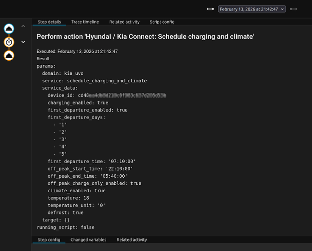

this is the trace of this action in a script.
It appears to send correctly formatted time values.
