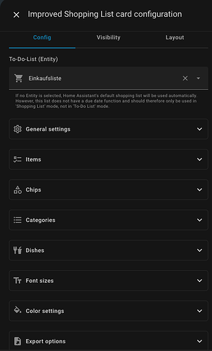

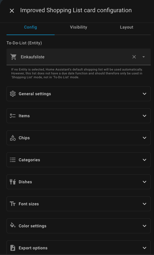

Its working :slight_smile:

EDIT: much much better than before :slight_smile:
