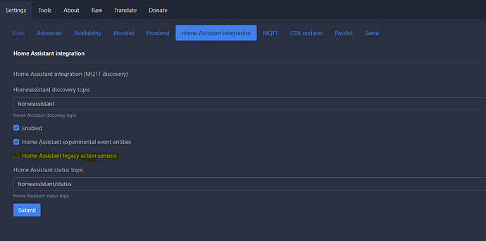

You can upgrade.
If you need the legacy action sensors; it is (for now) still available, just tick Home Assistant legacy action sensors and you will be able to use as before :wink:

Oh yeah - clicking the option Home Assistant experimental event entities or whatever inside zigbe2mqtt just gives me an erorr message.

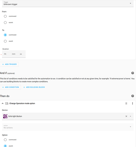

I have tried to create an automation that triggers on change of operation mode from command to event. And then have the action - change back to command. However while the trigger works, the action does nothing. This is seriously messed up right now.

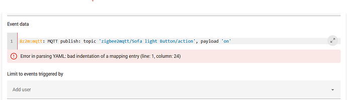

Explanation. I have no clue what I should enter here as event data - I copied in what happens from the log - but that’s just way too complicated. sorry
Now this really should work to clean up the mess, but it doesn’t
You say you want to avoid your device going to event mode, but your automation above does the opposite - it switches your device back to event mode when it goes to command mode.
Basically, change your trigger (When) to event and your action (Then Do) to command.
oh yeah, sorry I got it now. I had changed to inverse because nothing happened. It was not really about the automation.

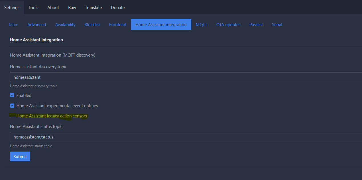

So in order to have it working I need to enable experimental mode, and enable legacy mode. Only then I can create an automation that will work.
When I had experimental mode off, and legacy on - than tripple tapping would change to event mode - but there was no way to get out of it without tripple tapping again. That’s very counter intuitive.
The really confusing thing is before you activate the experimental mode, you cannot get back out of it except on the device itself.
Also only after activating it - I found events that I can use in automations. Strangely for the button only single click and double click have an according event. The hold action does have no event so it does not work in event mode.
So this is really a bug. If zigbe2mqtt has not enabled the experimental mode - it should not allow any devices to switch to event mode. Because without experimental mode enabled, event mode will fail.

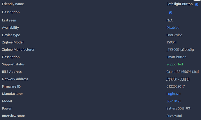

Sorry, you lost me, and the fact that you haven’t even mentioned which device you’re talking about doesn’t help make things any clearer.
Device type
EndDevice
Zigbee Model
TS004F
Zigbee Manufacturer
_TZ3000_ja5osu5g
Description
Smart button
Support status
Supported
IEEE Address
0xa4c13846569613cd
Network address
0x80E8 / 33000
Firmware ID
0122052017
Manufacturer
Loginovo
Model
ZG-101ZL
This device - a simple zigbee tuya button. Only after I enabeld the experimental event mode under z2m settings I was able to solve this.
