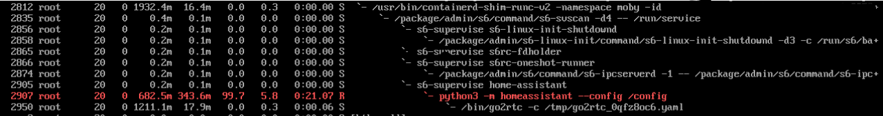

EDIT: When it happens, I see this process responsible for the issue (I used ‘top’ from the command line):

I added the process that is getting stuck in my initial post.
doesnt need to be special. It will look normal.
question is what was running when CPU spiked.
HA as a whole doesnt just burn CPU so not likely an base HA issue. It could be addon. so the thing to look for is which addon is causng the problem. the python process you see running is the HA software running. that’s normal. The addons are included in that I believe and are likely the issue.

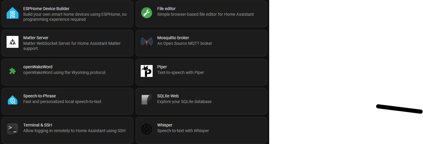

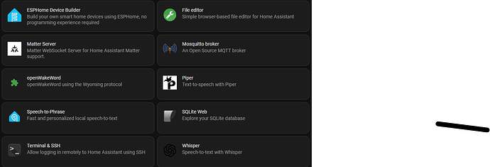

For completeness sake, here are all the addons I have installed:
Thanks in advance

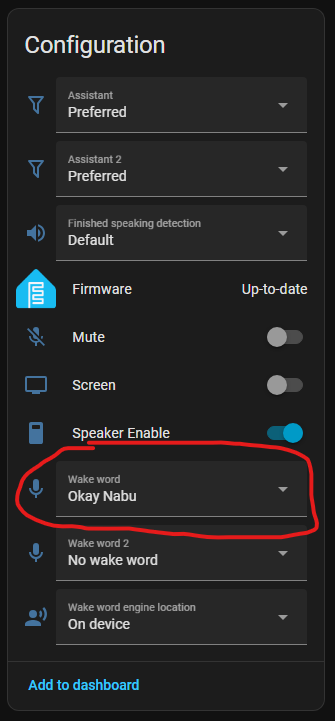

Digging around looking at the configuration of everything, I noticed that the ‘Wake word’ entity was disabled for these devices. Enabling this again appears to have resolved the issue for me.
Happy to hear you solved it for you, unfortunately the circled option in your post was grayed out in my setup (I have no idea why).
Just for giggles, I changed the option below, “Wake Word engine location” from ‘on device’ to ‘in Home Assistant’, which immediately triggered the issue (100% cpu, interface unresponsive/down). What started just for giggles quickly turned into a nightmare, as I could not revert this change. For me to be able to revert it, the device needs to be on/connected, but as soon it connects now, HA goes to 100% and unresponsive.
