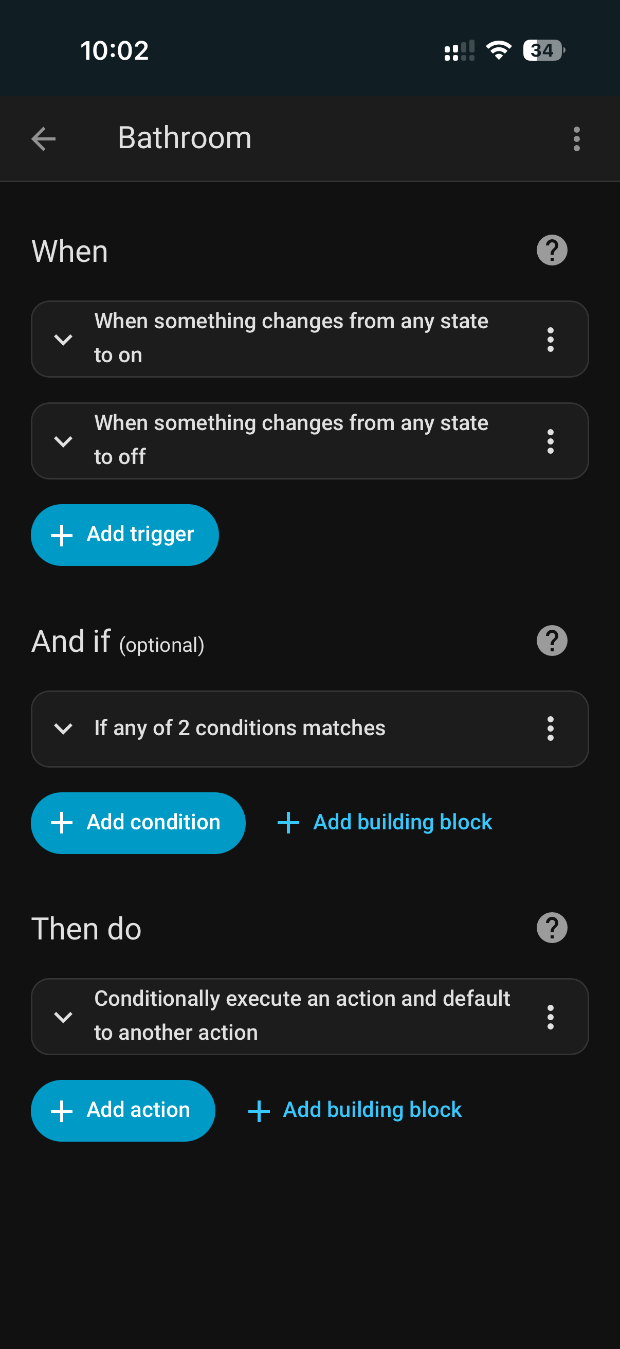

Using zigbee smart sensor model C3007 to automate my 4 rooms. Having so much issues
I purchased these sensors off aliexpress shame on me for going cheap but money is tight thanks to someone. I installed 4 zigbee mini pir motion detectors. I tried my best to setup an automation it will turn on when entering the room but after a few minutes it goes off. Also the zone size the sensor picks up is to huge that I purchased throw away drinking cups in red and still it picks up outside the area I want it to.
So I made quite a few of these automations and none do what I want. When entering a room lights on and stays on until I leave. Can someone please help me on what to do cause I can’t figure this out myself and it’s stressing me out.
I wish I could upload more pictures cause that’s just one example. If someone is trained in rbi’s area I would appreciate the help. I should note this is the sensor
Please follow Questions Guidelines 14 and 11 by sharing automations as properly formatted YAML… screenshots are rarely detailed enough for us to get the full picture.

This is what I have. I use this for all 4 rooms, just change the names from office to bedroom, also the entity_id needs to be changed as well.

I’m surprised your automation ever worked at all because that’s not the actual entity ID. It should be something like binary_sensor.your_pir and not an alphanumeric string.
In fact, your earlier screenshots of the UI shows that it’s struggling to recognise what your referring to. You can see the trigger is saying “When something changes…”
