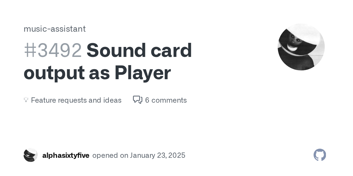

The next Music Assistant release will support this. Is your best bet.
