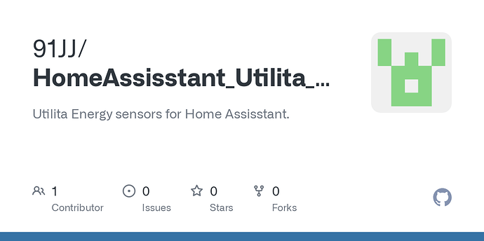

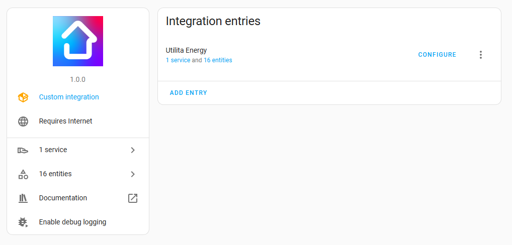

I finally decided to have a go at my own Custom Integration.
For years I’ve been manually pulling my Gas / Electric balance so I decided to try and automate it into Home Assistant :slight_smile:.
This is literally my first Repo, so please be nice lol.
There’s still some work to do to ensure if the URL/APIs fail, it doesn’t kill anything else. I’ve tested for a couple of weeks and it feels stable.
NOTE:
  • This isn’t officially supported by Utilita and could break at any time.
  • This has only been tested with PAYG (Pay As You Go) accounts.

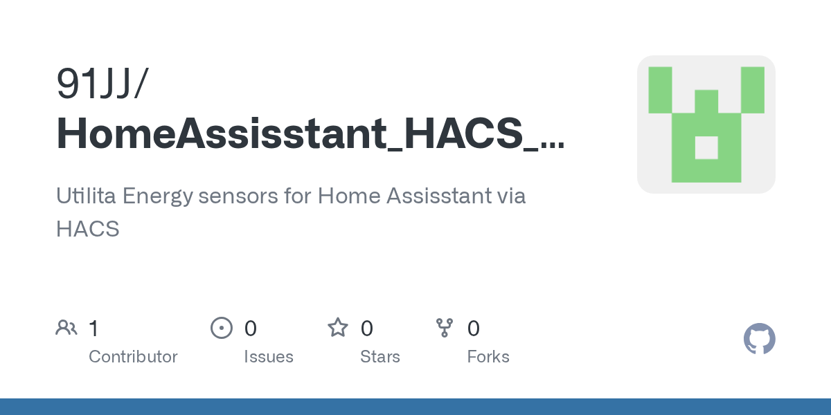

I’ve now made this possible via HACs …!
