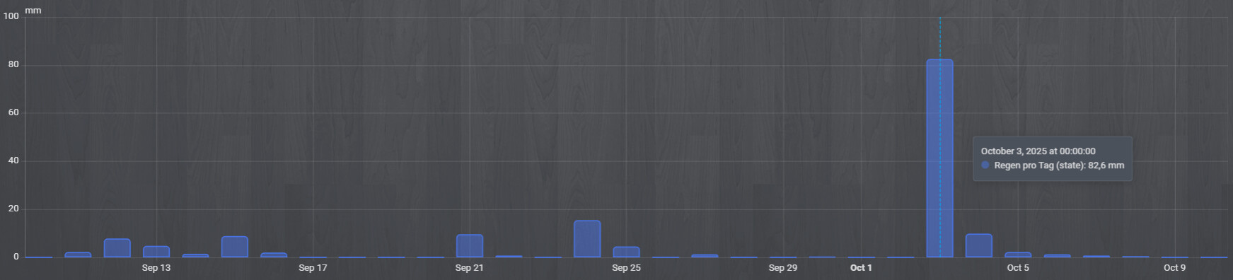

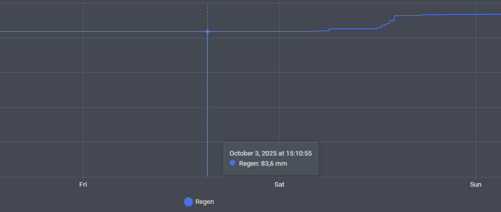

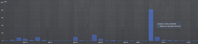

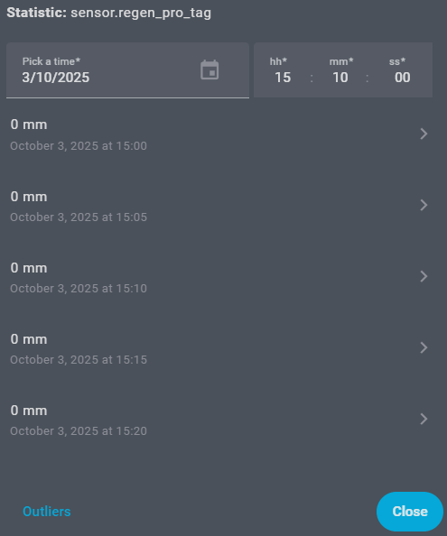

I corrected the statistics manually via the Outliers button but the Charts still show the glitch:
State Sensor
Statistics Card
Statistics
No outliers …
