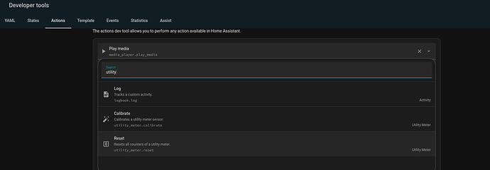

there is an action/service to either reset or recalibrate a utility meter helper. Go to dev tools > actions and search for ‘utility meter’. IIRC, reset has some quirks, so its better to ‘calibrate’ and set the value to ‘0’.
You can create an automation to trigger every X hours and run the recalibration on 1 or more utility meter helpers.
