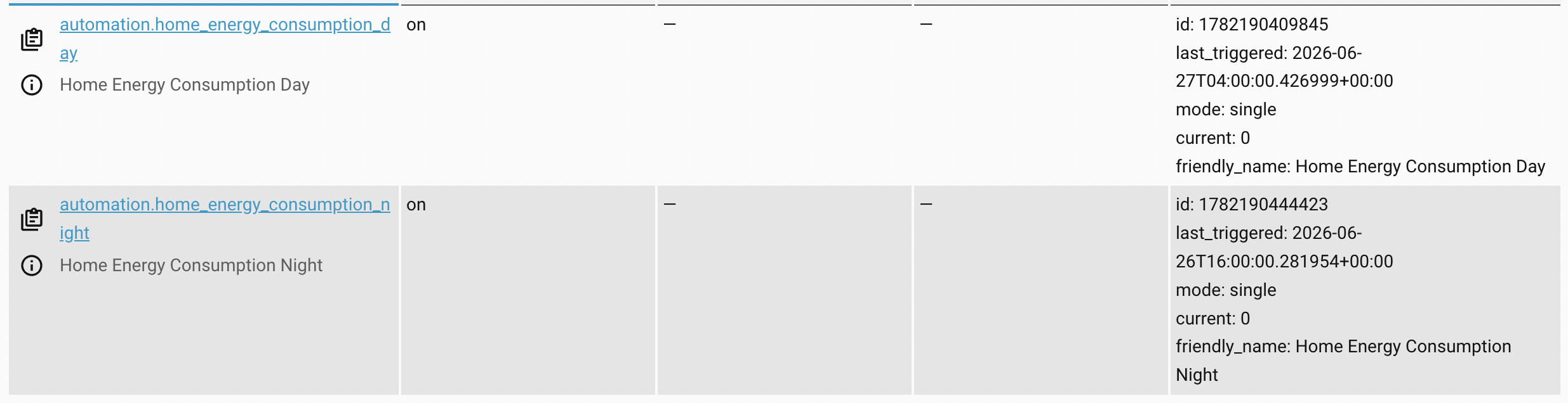

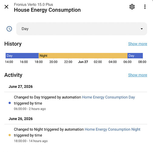

Then I have create an Utility Meter with the Integral Sensor above. I created two tariffs, day and night.
I change the tariff at 6am and 6pm and at the same time I reset the Utility Meter Sensor.

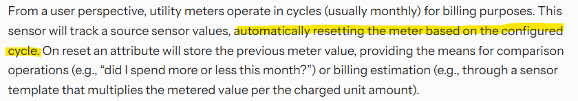

That's literarily how utility meter work.

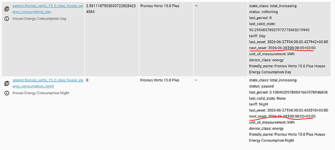

Show us a screen shot of its attributes from the developer tools -> states page.

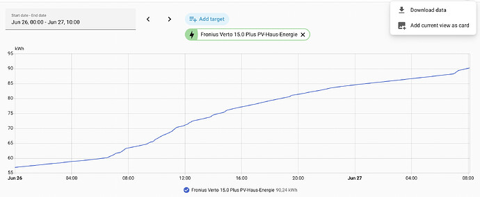

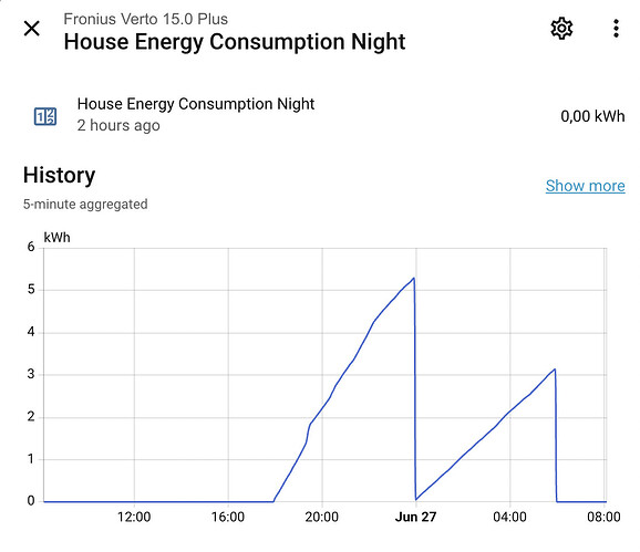

Also the source sensor for the Utility Meter doesnt get reset at midnight:
ebnerjoh
(Johannes Ebner)
June 27, 2026, 6:07am

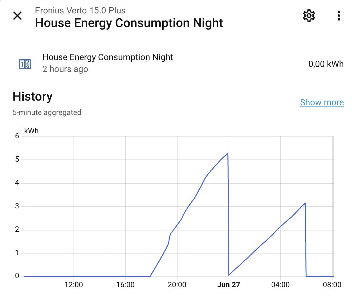

9
but the night tariff gets.
tom_l
June 27, 2026, 6:08am
10
Of your utility meter not your automations.

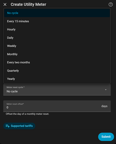

Where could this midnight reset be set? I have set up the utility meter from the UI.
It's one of the options when you set up the helper. Default is no cycle, so you might have selected daily by mistake
There is also an option further down called "Periodically resetting" which you might want to disable because it's enabled by default.

Because I am pretty sure I have selected "no reset" when creating it. We will see now at midnight. I have newley created it and now am 100% sure, that I have set "no cycle".
Or you can go to the helpers screen, click the 3 dots next to your helper & select Settings. That should show you whether it's set to no cycle or daily.
