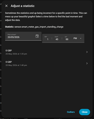

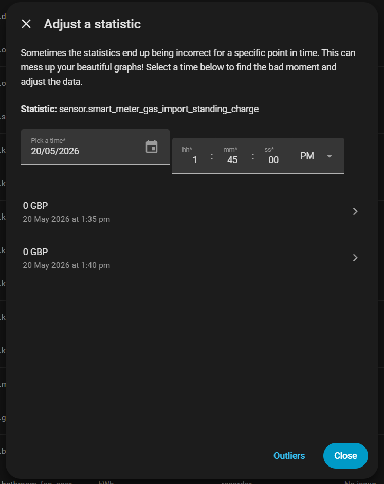

If you go into dev tools, statistics, you can click on the ramp on the right of the entity, and edit the outliers there:
That's useful to know - thanks. Fingers crossed the meter behaves again :+1:
