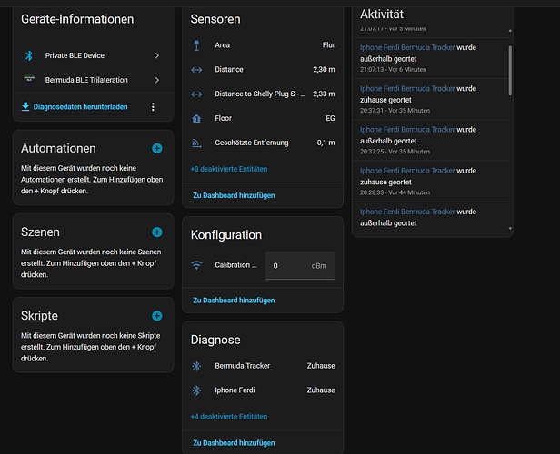

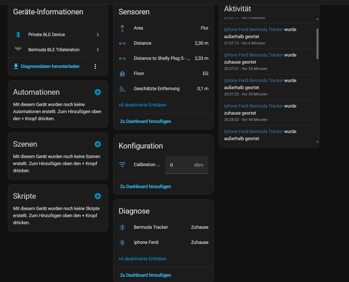

Hello @doktormerlin,
thanks for your nice Blueprint.
I do have a problem with installment:
For me it does not show an area.
Do you have any ideas why?
LG,
Ferdi :slight_smile:

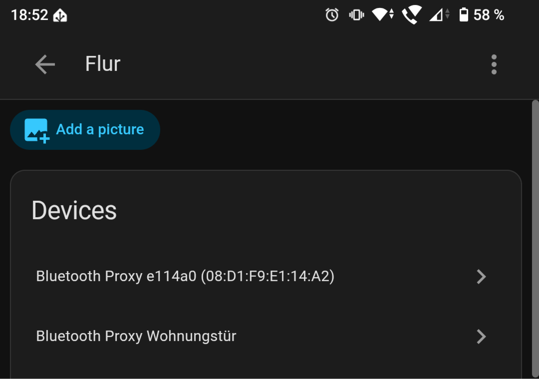

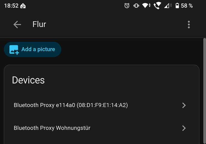

Hi Ferdi,
I’m glad you got bermuda to work, that’s the trickiest part :slight_smile:
For the area: You need to add your Bluetooth Proxy Device to an Area, so that this shows up. Do you have this? Can you see in the Bermuda Integration that your device is correctly set up?

Hey Merlin,
Thanks for the quick answer!
this is how it is looking for me.
According to my understanding the Bluetooth Proxy Device is added to an area, but still no area shows up.
Thanks for the new blueprint :slight_smile:
Thanks. I too am experiencing the same issue, so would welcome some advice.
Do you guys have the devices added to the Area in Home Assistant?
also what kind of Bluetooth Proxies are you using? Maybe “ESPHome” is a bit too restrictive for the bluetooth proxies
@im.woodward @Ferdi27
I am Using Shellys for my Bluetooth Proxy.
I can see them in the Bluetooth App
I can see them in the Area Section
But I can’t select Area in the Blueprint
