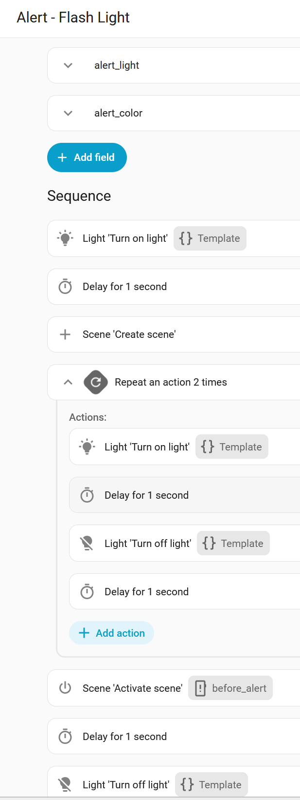

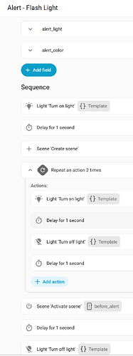

I then setup on automation to save the current state after turning on the HA LED light.
I use the light and RGB color as fields to call this from other automatons. I send in the light and the color I want for the alert. I was thinking of even adding fields for how many flashes and the delay length.
The automation will flash the light one time as it’s current set color, flash twice as the chosen RBG color, flash once as the original color and then turn off.
sequence:
  - action: light.turn_on
    metadata: {}
      entity_id: " {{ alert_light }} "
      brightness_pct: 100
  - delay:
      hours: 0
      minutes: 0
      seconds: 1
      milliseconds: 0
  - action: scene.create
    metadata: {}
      scene_id: before_alert
      snapshot_entities:
        - light.joe_led_ring
    enabled: true
  - repeat:
      count: 2
      sequence:
          metadata: {}
            rgb_color: " {{ alert_color }} "
        - delay:
            hours: 0
            minutes: 0
            seconds: 1
            milliseconds: 0
        - action: light.turn_off
          metadata: {}
          data: {}
        - delay:
            hours: 0
            minutes: 0
            seconds: 1
            milliseconds: 0
  - action: scene.turn_on
    metadata: {}
    data: {}
      entity_id: scene.test_scene
    enabled: true
  - delay:
      hours: 0
      minutes: 0
      seconds: 1
      milliseconds: 0
    metadata: {}
    data: {}
    enabled: true
fields:
  alert_light:
    selector:
      entity: {}
    default: light.joe_led_ring
    description: Light for alert
    required: true
  alert_color:
    selector:
      color_rgb: {}
    required: true
alias: Alert - Flash Light
description: ""
icon: m3o:person-alert
