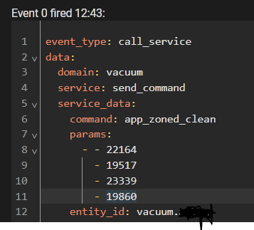

Noticed one issue though: Zone cleaning does not work correctly. With a little debugging, the problem seem to be in app_zoned_clean parameters missing the last parameter - the card seems to send the command like this:
When sending the command (in Devtools) like below, it works correctly
action: vacuum.send_command
  command: app_zoned_clean
  params:
      - - 22164
        - 19517
        - 23339
        - 19860
        - 1
  entity_id: vacuum.xxx

I see that you have added this line:
Room cleaning should work correctly after removing it

Ok, how about the zoned clean? It does not seem to work with “repeats” parameter…
It would be much harder to override it for zone cleaning, so I suggest a different approach (it will work for both room and zone cleaning, so you can remove the config from my previous comment).
card_mod:
  style: |
    .map-actions-item:nth-last-child(2) {
      display: none;
Perfect. That does the trick. Thank you!

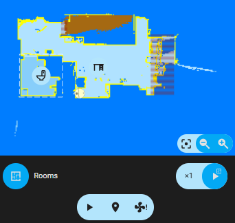

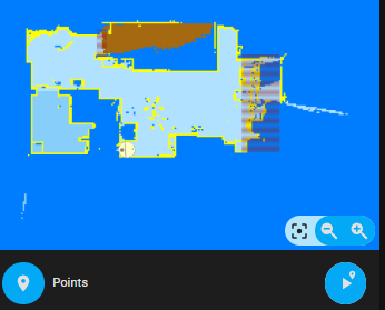

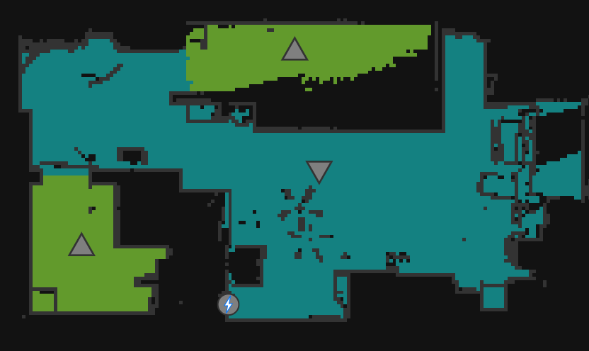

I just flashed my Roborock S5 with Valetudo and tried to add it to home assistant.
I created 3 segments to seperate different rooms in Valetudo:
I wanted to define a predefined point for the vacuum_goto_predefined but it is not visible.

I already defined predefined selections and they are shown in the map

As the predefined selections are shown i guess the position is correct.
What am I doing wrong?
