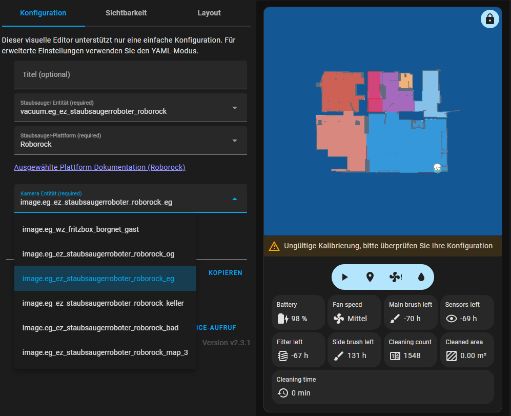

I just have some trouble to get the map to work … I’m using Roborock and installed the GitHub - Lash-L/RoborockCustomMap as instructed.
I think it should generate duplicated maps ending on “_custom” but they don’t show up for me.
Any advice?
Thanks in advance! :slight_smile:
Have you also added this integration or just installed it?
:see_no_evil:
…Thank you, it works now!
