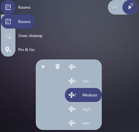

I don’t know if this has been mentioned: A few weeks ago the drop down menus stopped working - is this a bug, a change in HA in general or just my installation?
Running the latest HA 2026.3.4
Which ones? And in what way are they broken?
The drop downs are always open. I can still click the menu items, but it doesn’t collapse again.
I’m not really sure why it happens, it works perfectly fine on both of my HA instances. Do you use the latest version of the card?
That’s strange - I just noticed that I don’t see it in my HACS downloaded elements… So it could be that I use an outdated version. I have to dig deeper…
Thanks for the pointer as I assumed that I was automatically up to date…
Damn… I was obviously using an outdated version as it somehow fell through the HACS ecosystem. I redownloaded it via HACS and now it seems to work again!

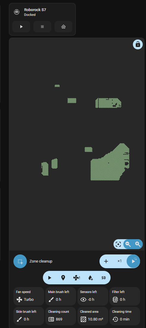

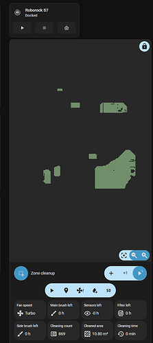

I’m wondering why my vacuum card looks so bad? its unusable, not sure what I’m doing wrong.
That seems to be a problem with map image, not the card itself
thank you problem solved. the custom map thing (which i needed to get roborock working) said to disable all the map features at first, now I renabled it all and it shows up great.
