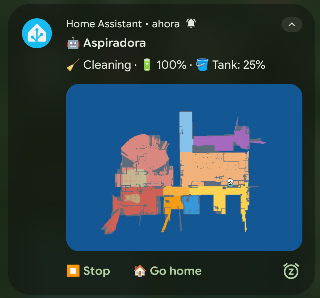

A persistent Android notification card for robot vacuums that stays visible while your vacuum is running, shows a live map snapshot, exposes action buttons to control the robot, and sends a final completion notification with the last map frame when it docks. No extra helpers required — just your vacuum entity, a tank sensor and a camera.

  • Current state (Cleaning, Paused, Returning to base, Idle, Error) with emoji
  • Battery level if available
  • Tank fill percentage from a dedicated sensor
  • Live map image from a camera entity (local or external URL)

  • Stop / Resume — dynamic label depending on current state. Uses a negative condition (not in ['cleaning', 'returning', 'docked']) to handle any non-active state robustly, including integrations that report idle instead of paused
  • Go home — sends the robot back to base
