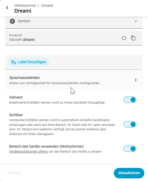

Have you marked segments as HA areas yet? If not, click gear icon from vacuum popup above > Map vacuum segment to areas.
Sorry didn't get any notification about your answer.
This is selected, see last option:
That´s weird, option should be right under Sprachassistenten you´re pointing there.

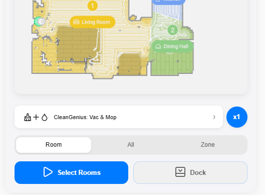

Do you have Dreame Vacuum Map Card installed? I´m not sure if that will make any difference but I´ve got also that installed and clean by area works great with my L40s Pro Ultra.
No I have the Lovelace Vacuum Map Card installed.
Have now installed also the Dreame Vacuum Map Card too, but no effect.
Can you make your robot to clean certain area from Vacuum Map Card?
In the new installed Dreame Vacuum Card I can select "room" and select the rooms on the card.
But I have not tested it if it works. Normally I do this via the Dreami app if I want to clean one room.
