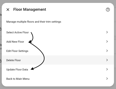

In the DOCS as explained already as now we have Floors Support, the trems are in the floor data… It means in Image Setting:
Updated the Floor Data → new trims: will automatically edit the floor:
SubMir → Back to the main menu → Save Options and the trims are applied…
The services for this are not yet implemented but will do it as soon.
Thanks. Adding a floor and updating the trim data did the trick.

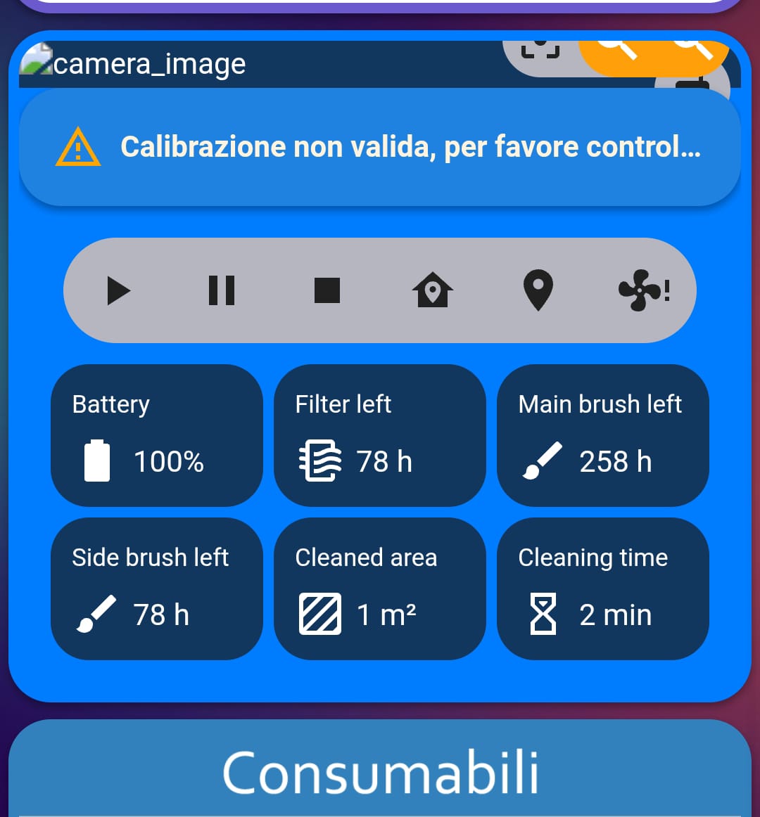

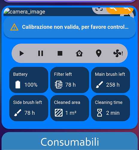

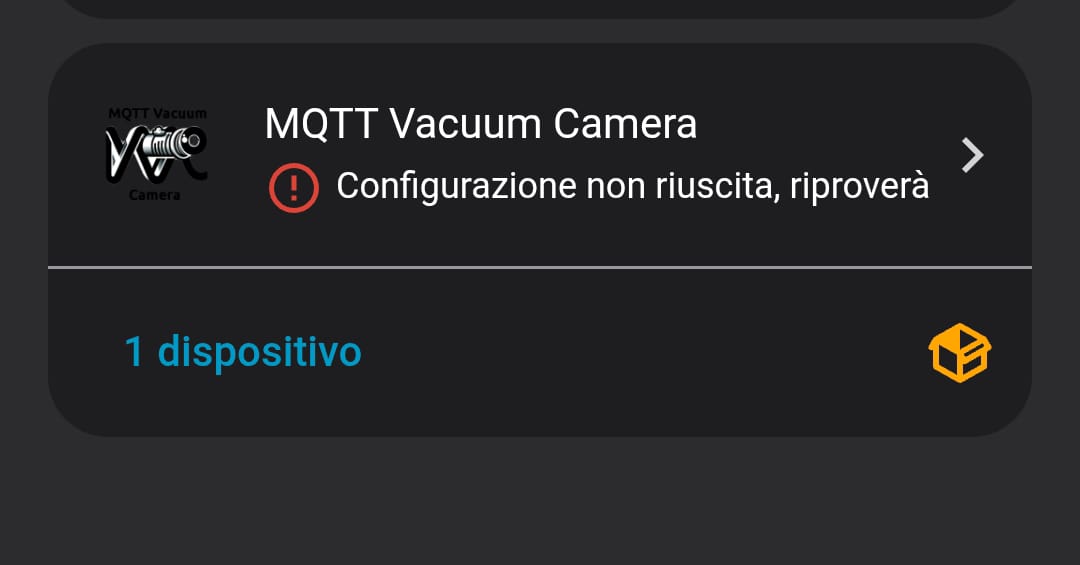

hi guys! I hadn’t updated Home Assistant for months because I was afraid the integration wouldn’t work. Today I decided to update it, and it happened… any ideas on how to fix it? I’m on the latest version of Home Assistant and the latest version of MQTT_Camera, firmware version 2025.05.0. Thanks everyone! :slight_smile:
@kill_one Try to update the vacuum firmware too please and use the stable version not the the beta one instead. This should solve the issue, as the vacuum actually is rejected from MQTT because of deprecated values.
@gsca075 Thanks a lot! now it works perfectly :slight_smile:

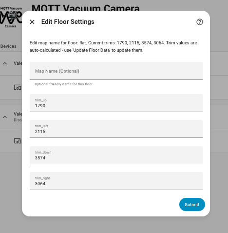

I’m not going to post an issue as of yet, I don’t want to recreate the situation :smiley: (but if you need, lmk and I’ll do it, this time I know a quicker way out)
I turned on debug logging in case something happens, what made me do it was when i changed trim levels in integration settings, HA restarted. I was sure it will be gone again, but it came back. Didn’t touch the trims since, because they also didn’t do anything for me - ā€œEdit Floor Settingsā€ saved my settings but when proceeding to ā€œUpdate Floor Dataā€, it still had the old value.

Yes this is what I kind of expected… I did several test and floor_0 is as it is suppose init correctly in the library if not defined in the config… as it is the default floor when HA isn’t configured in floors mode… and I repeat we use the ID’s of the floors but the management of the floors (add or delete) is in HA. We just record the trims of the floors id’s if any or in floor_0 if none as we need a key to grab the data… simple like that.
The data are stored then a floor_0 can be activated and you can update the trims when needed.
Ok it happened again, now this time while changing trim values (it still doesn’t change my camera feed image, I was just trying).

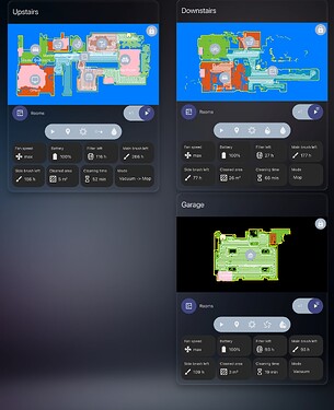

is multiple floor functionality also available for Congatudo users?

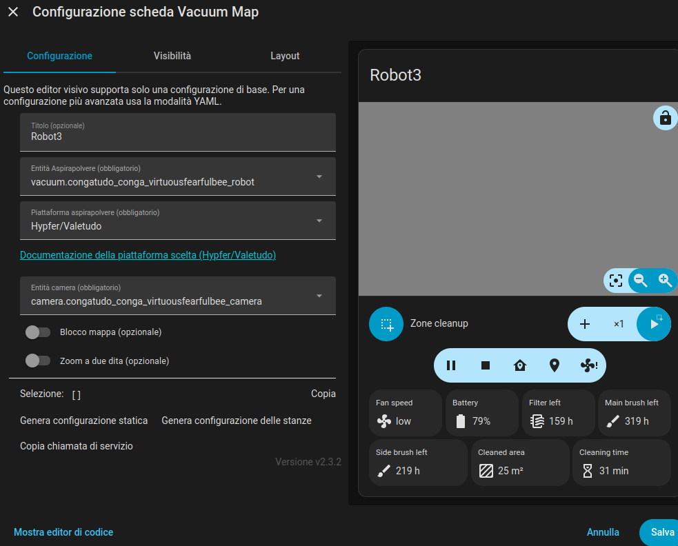

I ask this because I have a Conga 4090 (iirc it is multi-floor capable) running Congatudo 2026.2 embedded and didn’t find a way through adding a map for each floor.
If I follow instructions located at mqtt_vacuum_camera/docs/floor_management.md at f425a3a5ba58dd2c8510442f7a585aa10072aad9 Ā· sca075/mqtt_vacuum_camera Ā· GitHub and create a new floor I eventually end up with a blank camera image:
any clues?
@frastill yes the multi floor might work also work for Congatudo the vacuum might have a map after scanning the floor grey means there are no maps for that floor yet in the vacuum. Aldo Congatudo is still maybe buggy in my implementation will be happy to help you understand where the problem is if you open a discussion in GitHub we can see if it will be necessary to open an issue
