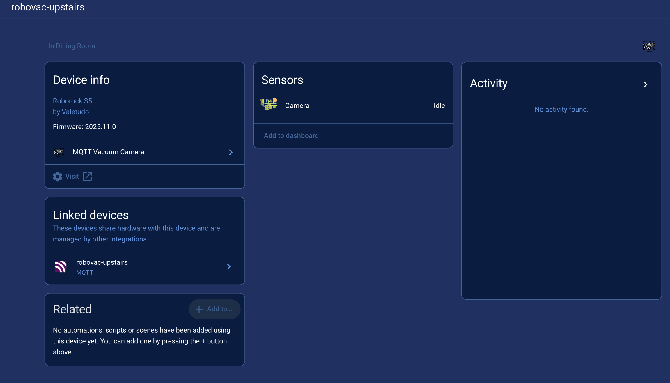

Small heads up for the August 2026 release tomorrow. The camera will now be shown as a linked device rather than part of the valetudo vacuum device.
It does not affect operation in any way.

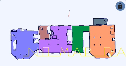

The reason I ask is that I have not run my vacuum for a couple of weeks due to there being no one home to make a mess. The card currently displays “No Map Data”
However the data is still present in Veletudo.
I’m seeing the reverse - ‘No Map Data’ has appeared as an overlay on the map for my vacuum that ran yesterday evening, and with no vacuum trace or vacuum icon. But it isn’t showing on the maps for the two vacuums that haven’t run since I updated them to Valetudo 2026.08.0.
Is it something to do with the new camera streaming capability introduced in the latest Valetudo? Can’t find the settings to enable it in mine, but they may be too old ( Roborock S50 and Dreame S10).
My data overlay came back. Not sure when or how. I’ve dome a few restarts today while fixing other things.
Try a HA restart.
I was just going to post the same - did a restart for another component update, and now it’s back. Wonder if it will stay though.
