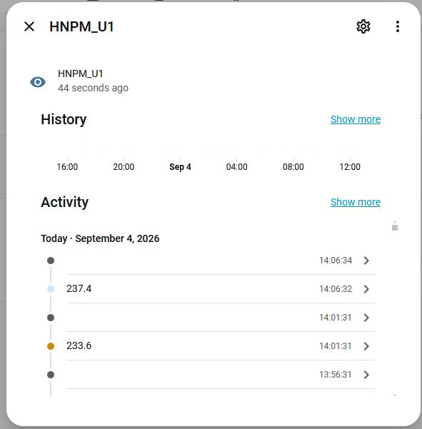

Dear Collegues,
Could You advise with folow situation, please?
I have integrated by MQTT electrical measuring parameters. The configuration.yaml add follow (see screen)
In HA on the dachboard history grapfic and value are missing (see screen)
In the same moment i can see that MQTT sensors are active (see screen)
What do I wrong?

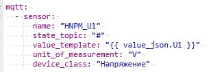

Dear Tom,
Thank You for advice. I am just starting work with HA and i can’t easy write code in yaml. Can i ask for You write, please, here additional what You mean
mqtt:
sensor:
state_topic: “#”
value_template: “{{ value_json.U1 }}”
SergeyT
September 6, 2026, 11:46am
4
anon11644107:
unit_of_measurement

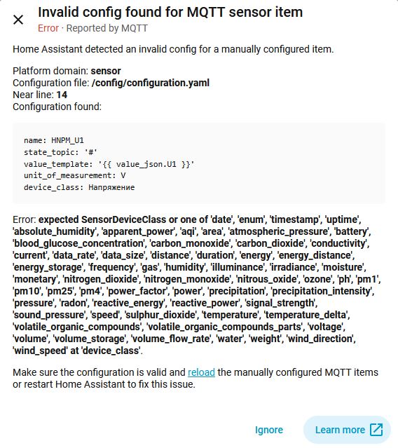

…i tried do it (see screen)
but systems is fault information (see screen)
Am i wrong?
device_class: voltage
state_class: measurement
unit_of_measurement: "V"
The list of valid device classes is here: Sensor - Home Assistant
