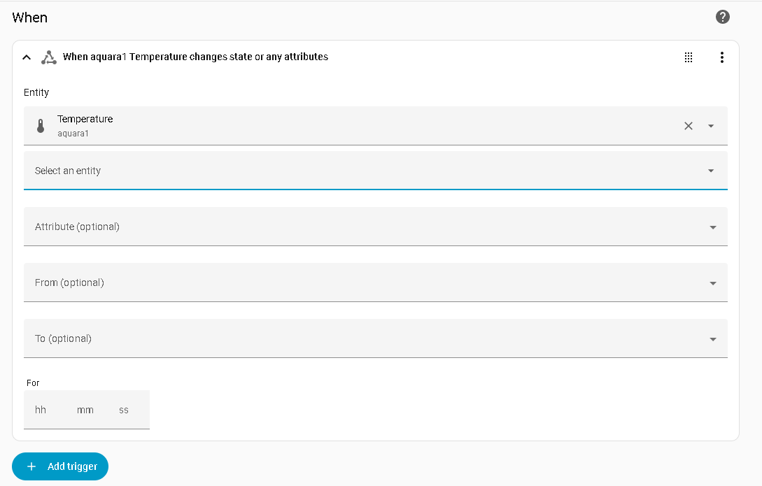

So I’m trying to create a new automation that will let me know when the set temperature of my fridge changes but I get the message:
Message malformed: must contain at least one of below, above.
Since I want the trigger to go off regardless of the value, how can this be achieved? I understand the uses of above and bellow, but sometimes they are not needed.

This should do it
Unintuitively you use a state trigger, not a numeric state trigger.
yea, this worked and I think it does what I want it to. thanks!
