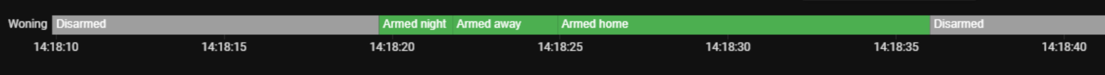

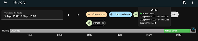

below a screenshot of the alarm status history as recorded in home assistant:
also during a second test where i waited for almost a minute before disarming the alarm did not lead to the gateway communicating a ‘triggered’ status:

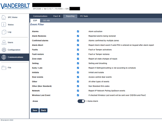

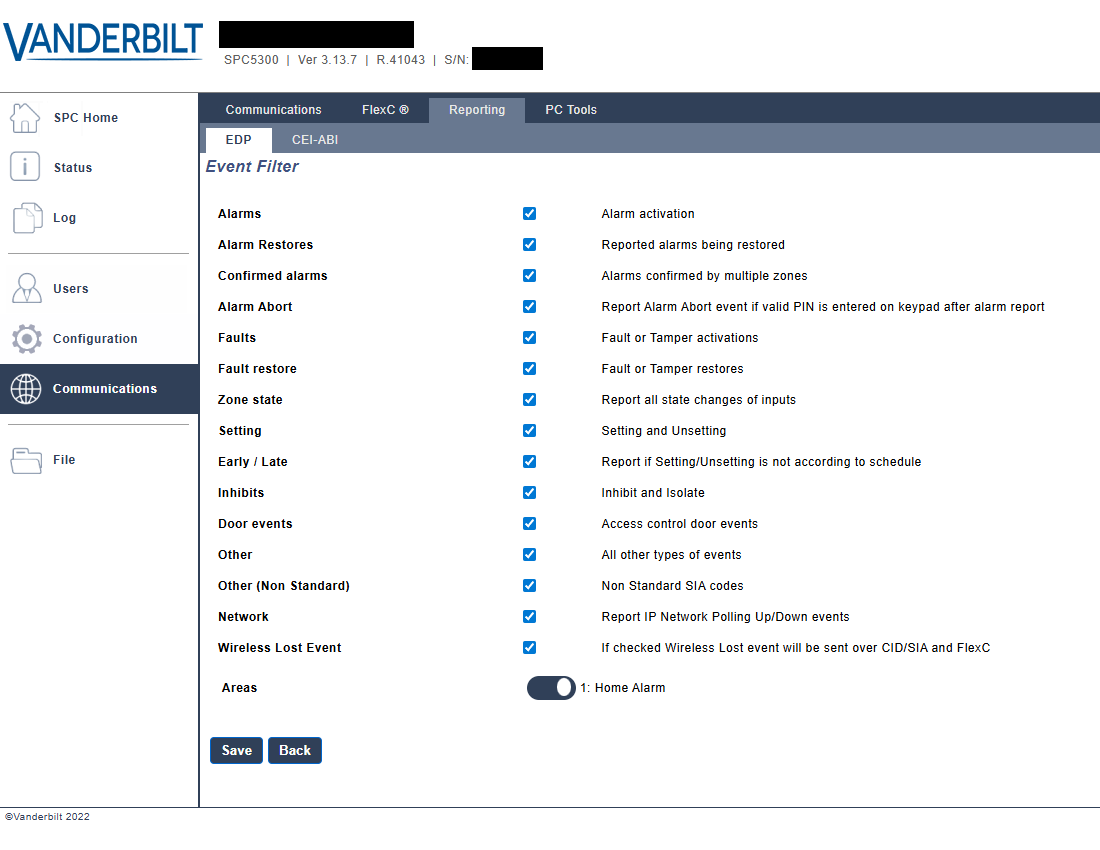

As far as i can see on SPC alarm panel side , the event Alarm Activation shoudl be communicated over EDP.
The Lundix SPC webgateway is also working as all other statuses are displayed and i can arm and disarm the alarm via home assistant and have automations working that use door, window and motion detector sensors from the alarm system.
