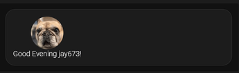

It throws an error for this :arrow_up: I am still playing with the user.nameportion
type: custom:button-card
entity: "[[[ return \"person.\" + user.name.toLowerCase(); ]]]"
show_entity_picture: true
   let Time =  new Date().getHours();
    if (Time < 13) return "Good Morning " + user.name + "!";
    if (Time < 18) return "Good Afternoon " + user.name + "!"; ;
    if (Time < 24) return "Good  Evening " + user.name + "!";
styles:
  card:
    - margin: 0
    - border-radius: 20px
    - padding: 15px 295px 15px 1px
  name:
    - font-weight: 300
    - font-size: 15px

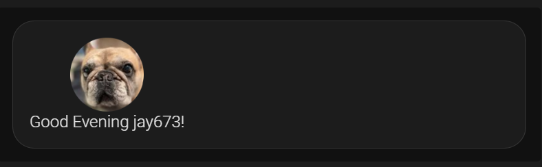

Thanks much, I was able to include greet text. I am looking to control the card size and the placement of the entity image to either left or right. How can I achieve that? Seems the entity image is aligned to center and if I reduce the width of the card, that also shifts the image.
show_name: false
styles:
  card:
    - margin: 0
    - border-radius: 10px
    - width: 16em
    - padding: 1px 100px 25px 35px
  name:
    - font-weight: 300
    - font-size: 10px
  custom_fields:
    greet:
      - position: absolute
      - align-self: left
      - left: "-35%"
      - top: 28%
      - bottom: 28%
      - right: 0%
      - color: null

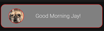

like this?
styles:
  card:
    - border: 1.5px solid red
    - background: grey
  name:
    - font-weight: 300
    - font-size: 25px
    - margin-left: -80px
  entity_picture:
    - border-radius: 50%
  grid:
        - position: relative
        - grid-template-areas: '"i n"'
        - grid-template-columns: 30% 70%
This works great. Basically I am trying to get a 7 column grid card. But if I specify the width in the card, it takes different width on different phones or devices. Below is the code I am trying with.
