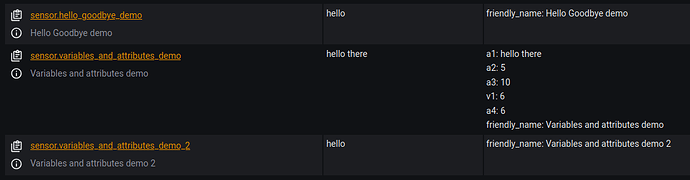

A demo (send an event 'my_custom_event' to populate the sensors)
- trigger:
    - trigger: event
      event_type: my_custom_event
  action:
    - variables:
        v1: hello
    - if: "{{ true }}"
      then:
        - variables:
            v2: world
        - variables:
            v2: there
    - variables:
        v3: "{{ v1 ~ ' ' ~ v2 }}"
  sensor:
    - name: Variables and attributes demo
      state: "{{ v1 ~ ' ' ~ v2 }}"
      attributes:
        a1: "{{ v3 }}"
        a2: 5
        a3: "{{ a2 + 5 }}"
        v1: 6
        a4: "{{ v1 }}"
    - name: Variables and attributes demo 2
      state: "{{ v1 }}"

I meant “below” in the top-down direction. I modified my example to better illustrate this: variable v3 “sees” v2, even though v2 is nested.

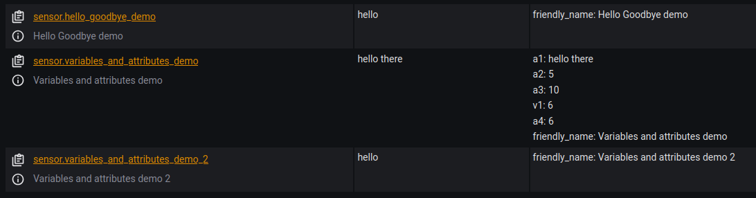

Top level variables work fine.
You can modify slimak’s example to use top-level variables…
- sensor:
    - name: Hello Goodbye demo
      default_entity_id: sensor.hello_goodbye_demo
      state: "{{'hello' if now().minute is even else 'goodbye'}}"
- triggers:
    - trigger: event
      variables:
        my_entity: "sensor.hello_goodbye_demo"
  variables:
    v1: "{{ states(my_entity) }}" #Included to show that top-level `variables` are not only Limited Templates
  actions:
    - if: "{{ true }}"
      then:
        - variables:
            v2: world
        - variables:
            v2: there
    - variables:
  sensor:
      attributes:
        a1: "{{ v3 }}"
        a2: 5
        a3: "{{ a2 + 5 }}"
        v1: 6
        a4: "{{ v1 }}"
      state: "{{ v1 }}"
…and it still works
