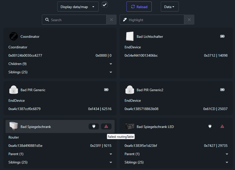

Various devices showing a red triangle with the error: "Failed RoutingTable"
in my Zigbee2MQTT map Device list various devices show the error: Failed: RoutingTable.
All devices are classified as mains powered routers. Most of them are Tuya power sockets, but not all, also some LED controllers. Devices showing this error have a good LQ.
So, what does this mean? Can I “repair” this somehow?
My understanding from reading posts in Zigbee2MQTT issues is that (no fault of Zigbee2MQTT) zigbee router devices have the option of NOT sharing their ‘routing tables’. I would really like get an understanding of why this is optional (if my read is correct).

Well, it isn’t really a problem. I don’t have any issues with tuya devices atm. I just was curious about this message.
Also other devices show this error: Gledopto, YSRSAI, Girier, NEO … but about 70% is indeed from Tuya devices.
Like David said. Looks like this devices simply block the routes query, which doesn’t seem to be a functionality problem directly.
