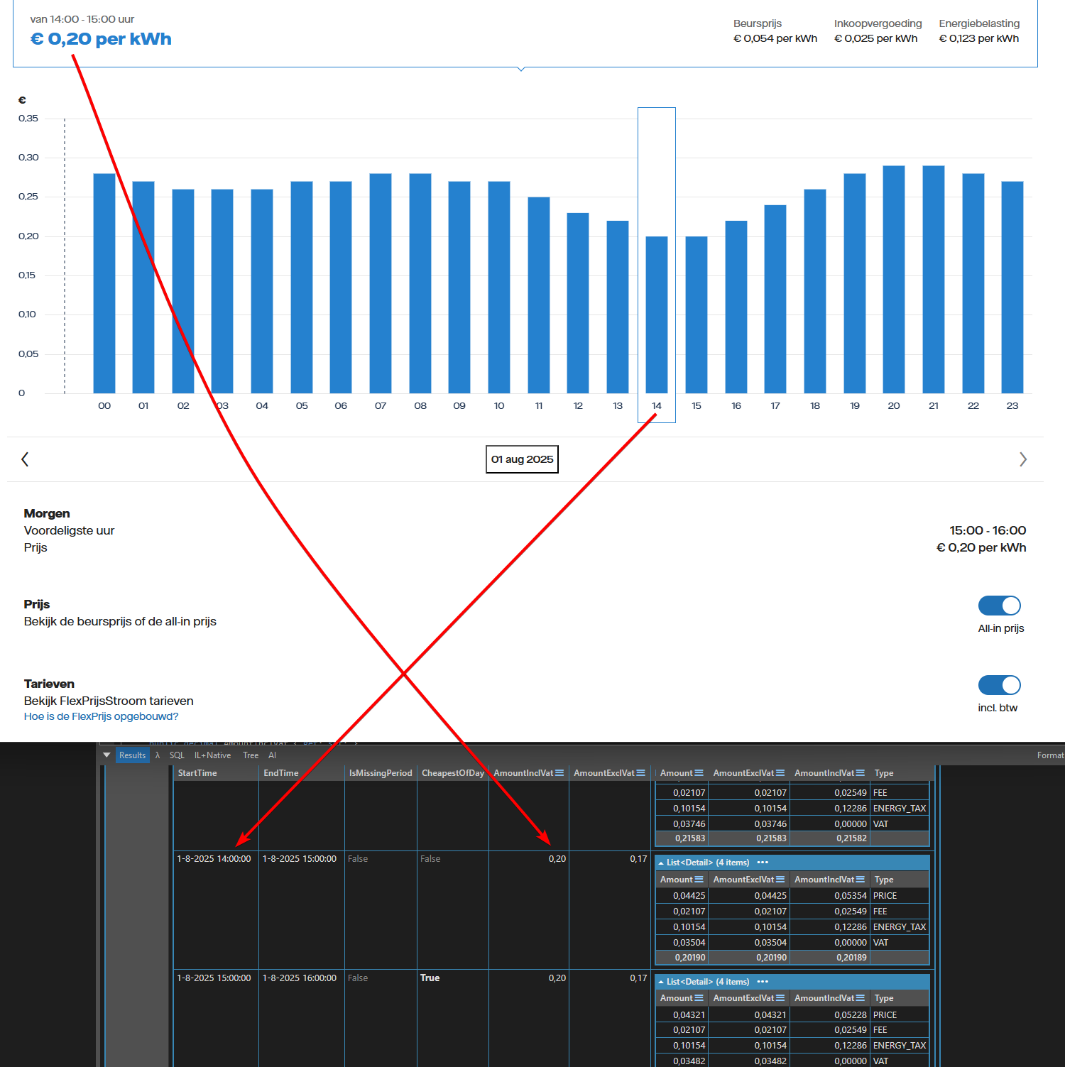

Sorry to poke this old topic, but I wrote some C# (LINQPad script) to extract the hourly price data, but this is a very volatile way of doing it: https://gist.github.com/Rene-Sackers/f62bd2b198f54ca3aff10be843fc3e83
On the Dynamische energieprijzen: dit moet je weten | Vattenfall page, they have an API key inside the JavaScript for the data. I haven’t found a direct API from Vattenfall that give you the hourly prices, which is incredibly odd to me.
The page gets the data from this endpoint: https://api.vattenfall.nl/dynamic-tariff-prd/api/v1 which I haven’t seen in any docs from Vattenfall, but I might have missed it.
The script basically loads that page’s javascript, uses a regex to extract the API URL and key, then downloads and parses the JSON data. I don’t expect this to be a long terms solution, but it’s something.
