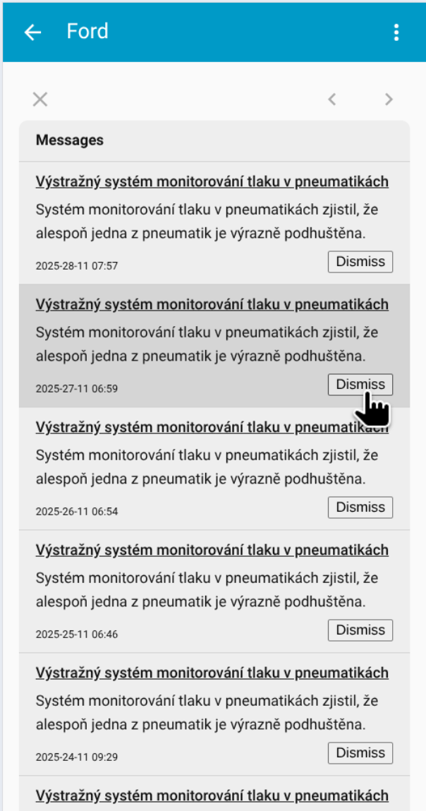

I would like to share a “messages”-style GUI within the Vehicle Status Card, with the ability to dismiss each message individually.
Ford provides a form of custom messaging, which appears to be used mainly for critical or safety-related notifications, such as low tire pressure. These messages are exposed via an entity attribute from the FordPass custom integration.
The integration also provides an action for messages removal.
Even if you don’t use FordPass, this approach can still serve as a useful design idea.
I believe this can be implemented in several ways. In my case, I used flex-table-card.
The key trick was to make only the Dismiss button respond to pointer events. Pointer events are blocked at the cell level and re-enabled only for the button itself.
I also adjusted the styling to make the component visually closer to the Vehicle Status Card.
Here is a code:

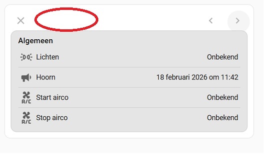

The second is a title i want here:
