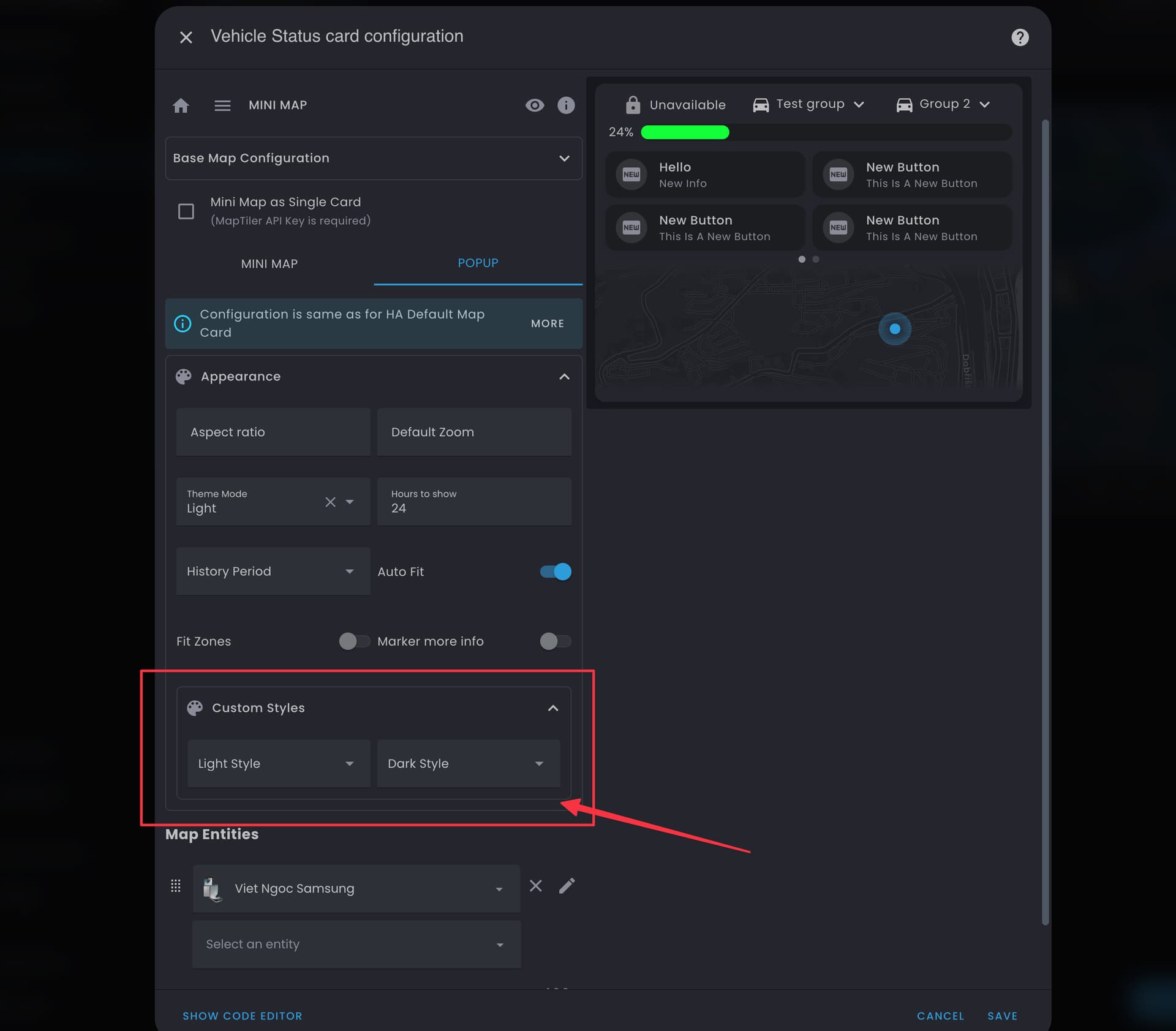

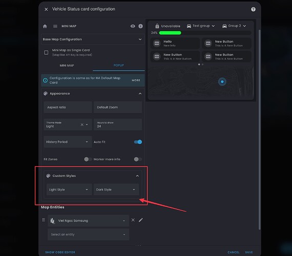

Hi, I have an issue with the latesta 1.5.x releases. When I open the popup map I normally see an option to choose different type or map layers, like satellite etc.
But since this release I just see the standard map. I have a Maptiler api key added to the code. Any ideas?

Hi @lagge78, there was a configuration change in the latest version. Now for popup map you can change the styles in editor, for dark or light theme. ![]()

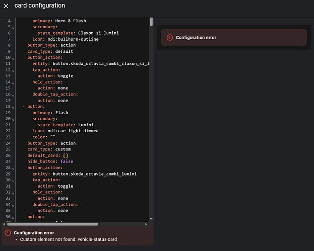

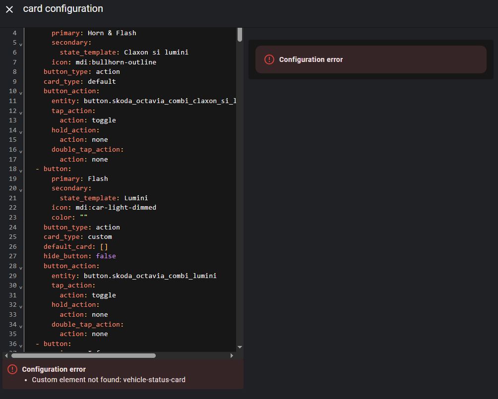

I tried to install it on my own HA instance and it keeps failing.
I am connected to the HA machine on my computer and I can add the card to the dashboard, customize it etc however when I save and refresh the dashboard on my tablet it gives me a “configuration error”. I can see it tho in my browser on the computer but not on the app on the tablet.
If I try to add it from the tablet directly I cannot even see the card.
I tried adding it as is without customizing anything and it still fails,
I tested with the latest beta release as well as with the latest stable.
If you have any idea why it fails and point me on the right direction I would really appreciate it. Thank you

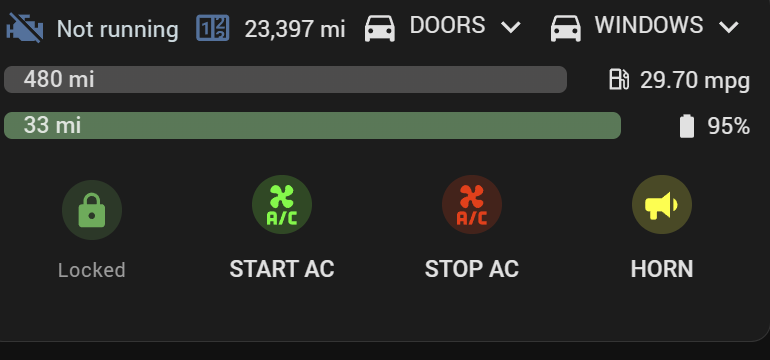

Is it possible to have conditional visibility for the Range Progress Bar?
I tried adding the visibility: with template like for indicators but it does not do anything.
Is there a way to add 3 entities to a progress bar? For example, distance to empty, charging percentage and time left to charge?
Hi, Amazing work. Is it possible to change the style of the custom cards.
I use OnStar2MQTT to access my 2025 GMC Sierra HD and the Mini Map on your card doesn’t work for me. I have “device_tracker.2025_gmc_sierra_hd_crew_cab” selected for the entity, but it never moves from the location it was in when I set it up.
Should the Mini Map work with onstar/GM vehicles?

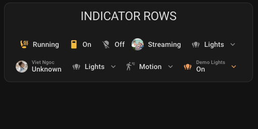

v1.16.0
What’s Changed
This release focuses on improving interaction and visual clarity across the card. It introduces a new action handler for more flexible button actions, sharper MiniMap rendering with retina support, and a new indicator rows system for better organization. Several bugs were also fixed, including progress bar limits and element layering issues.
Features
- Indicator Rows (#186)
Introduced a new “indicator rows” system, allowing more organized layouts and better customization options.
Bug Fixes
Progress Bar Maximum Value (#183)
Fixed an issue where the progress bar could go beyond its defined maximum. -
Z-Index Layering (#174, fixes #173)
Adjusted the layering order (z-index) in the component so elements display correctly without overlapping.
Maintenance
Action Handler Directive (#180)
Added a new directive to handle user actions more efficiently. -
Update
ha-button(#177)
Improvements and adjustments to theha-buttoncomponent for better consistency. -
MiniMap Retina Support (#172)
The MiniMap now looks sharper on high-resolution (retina) screens and has improved tile layer settings for clearer map details. -
Add custom icon size, custom templates options for indicator row items (#187)
Add new properties for row and column reversal in indicator components #188
