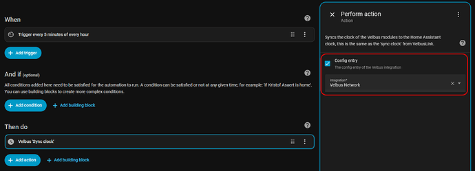

However when I look in the traces I encounter this error => error: required key not provided @ data[‘config_entry’]
What do I need to do to be able to sync my time correctly to my velbus?
Oh man I feel stupid :nerd_face:

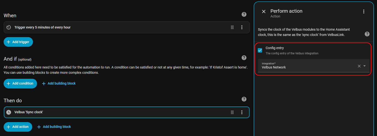

Once you set your automation you have to select the “Config Entry” and select your “Velbus Network”
