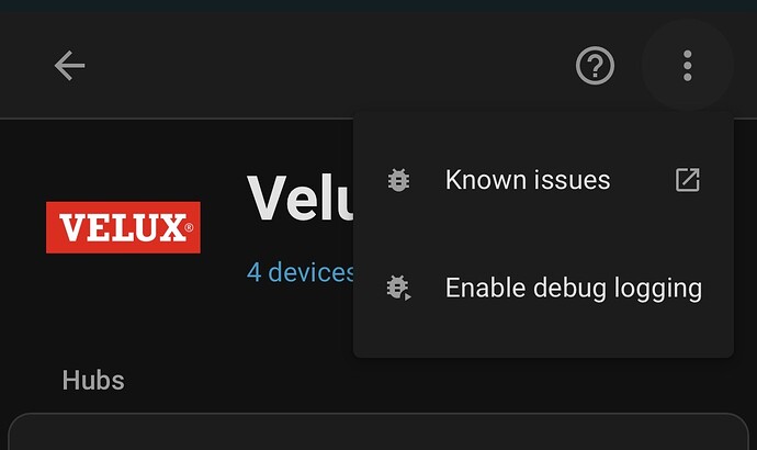

To enable debug logging clicking on the Kebab menu icon in the top right hand corner of the Velux integration page should be sufficient. Once you disable debug logging again, the log download should start automatically.

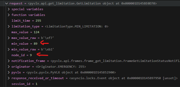

The best I can achieve for now is provide the result of get_limitation call from a self made script

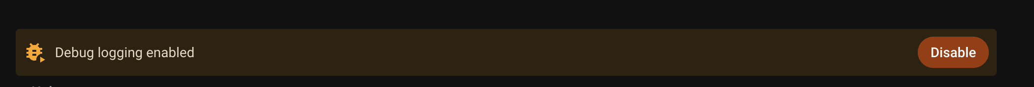

I do not understand why your debug logging does not work, does your HA show something like this once enabled in the UI?
But anyways, I think the output of your script should also be good enough. Please mention the type of your window when you open a github issue.
I think I got what you need. My window is a wired roof window with center pivot, installed in 2012 so quite old.
