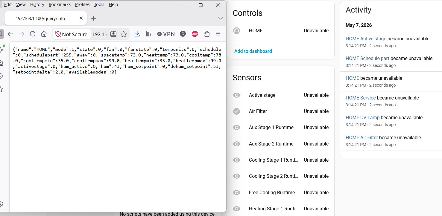

Is there a bug issue open, or have you reported an issue? Bug reports:
If it's a custom integration, do it in their git repo.
This issue hasn't been submitted yet. I wanted to ask the community before I did, just in case it might be something specific to my installation that I could resolve.
According to Venstar's API documentation, if you enter the following URL into your web browser (replace 192.168.1.50 with your thermostat's IP address) it should reply with information about its current state.
http://192.168.1.50/query/info
If it replies with data in JSON format then you have confirmed it is alive and communicating normally.
Thanks Taras - like with the Venstar Android app and Skyport web interface, the query/info is fine after H/A reports that everything as unavailable:
And then it recovers on its own and a few minutes later the cycle continues ...
In that case, it appears the problem is exclusively between your Home Assistant server and the Venstar thermostat (a software bug in the integration or a LAN communications problem).
requests.exceptions.ReadTimeout: HTTPSConnectionPool(host='192.168.1.100', port=443): Read timed out. (read timeout=5)
Maybe I am misunderstanding the error message but it's curious that it is attempting to connect via HTTPS on port 443. My understanding is that Venstar's API uses HTTP on port 80.
I suggest you report the problem as a new Issue in Home Assistant's Github Core repo and see what the maintainer of the Venstar integration has to say.
FWIW, the Venstar integration had two Pull Requests in the last two weeks but they would not have been included in 2026.4.X. The other recent PRs were months ago. All this to say that nothing appears to have changed in the integration since February.
Issue posted to: Venstar Integration - regularly raising errors when requesting and fetching · Issue #170067 · home-assistant/core · GitHub
