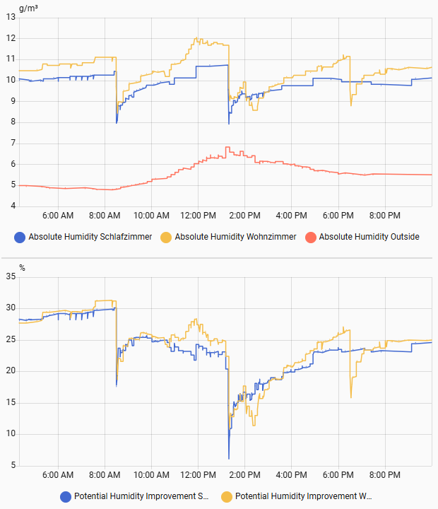

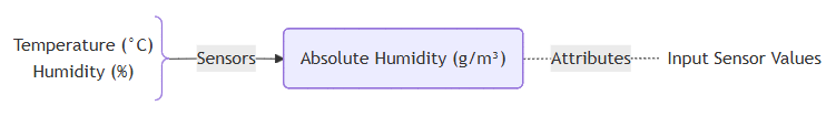

1. Calculate the Absolute Humidity :droplet:
This one is the most basic sensor. It simply calculates the absolute humidity based on Temperature (°C) and relative Humidity (%).
Can be used for statistics :bar_chart: or as trigger for automation :gear:. The Input values are also available as attributes:

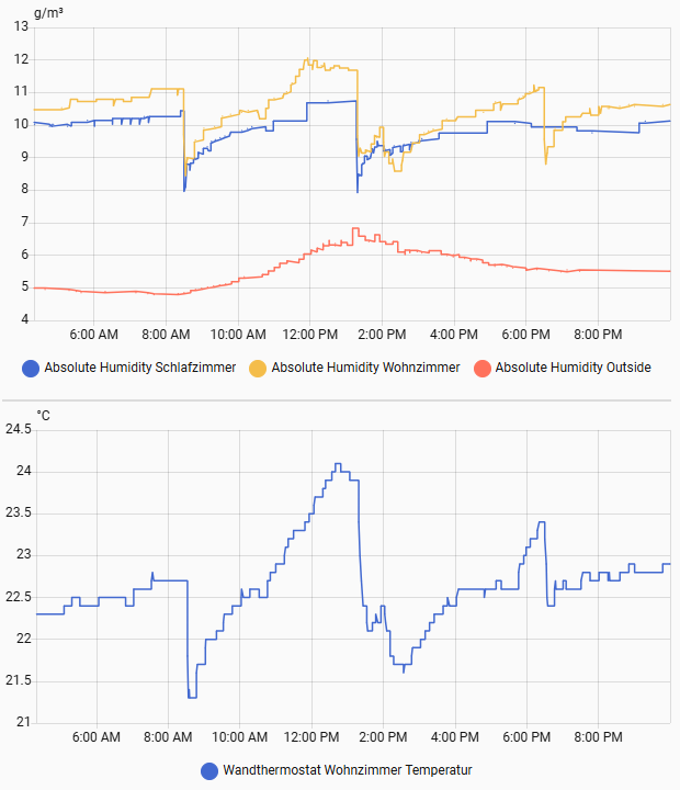

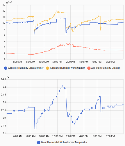

Note: You can see the cocking for lunch and dinner, as well as the ventilation having an effect on both: absolute humidity and temperature. Also the absolute humidity outside is always lower then inside. This sensor makes both values comparable!

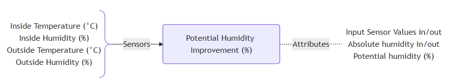

2. Calculate the Potential Humidity Improvement :chart_with_upwards_trend:
This sensor compares the inside and outside Temperature (°C) and relative Humidity (%) to calculate the theoretical improvement.
This is done in three steps:
  1. Calculates the outside absolute humidity
  2. Calculates the theoretical humidity with the air from outside
  3. Subtracts the calculate humidity from the measured humidity. Result = this sensor value

NOTE: When ventilation takes place, the potential improvement drops and rises again afterwards.

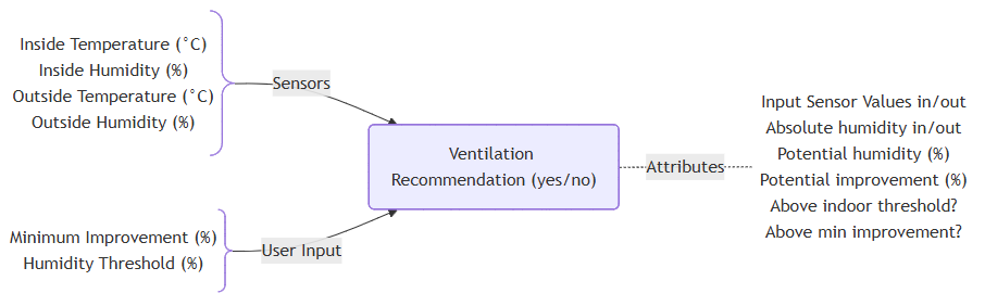

3. Ventilation Recommendation :vertical_traffic_light:
This sensor compares the inside and outside Temperature (°C) and relative Humidity (%) to calculate the theoretical improvement and directly give an advice if ventilation is recommended or not.
Can be used as trigger for automation :gear: or as an traffic light system :vertical_traffic_light: to inform users via UI or any external lights. The Input values are also available as attributes:

Obviously you need to fill the correct entity-id for each input sensor. Adjust the values for minimum_improvement_value and threshold_room_humidity if you like. You can set up one sensor for each room you want to track (living room, bedroom, bath, …).
