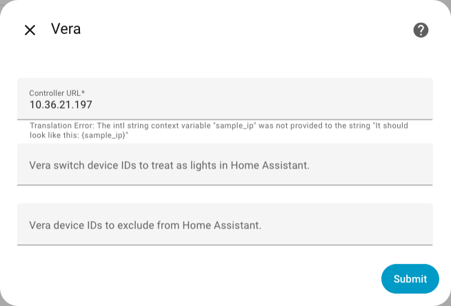

I’ve just now noticed that when attempt turn up the integration, there is an error message in the setup window.
It reads Translation Error: The intl string context variable “sample_ip” was not provided to the string. It should look like this: {sample_ip}
It will surprise no one to learn that I have no idea what to make of this. It doesn’t come up in a forum search.

That field is expecting a URL & you’re just giving it an IP address. At the very least add http:// before the IP.
If that still doesn’t work, then fire up the Vera dashboard & copy the URL from there.

THANK YOU!
I had been trying with and without http:// since the 1st suggestion.
Adding the port number was what I’d been missing. I assume 3480 must be the Vera API port.
If I may, this information really needs to be in the documentation for the Vera integration.
…just says add the integration and follow the instructions.
The pop up window for adding Vera integration does not mention port 3480 nor the required http://
I see it has an asterisk where it prompts
Controller URL *
as if perhaps there was meant to be a footnote explaining what’s required, but there is no such note (although perhaps that is just a reference to the apparently inconsequential error message).
Anyway, thanks all for the prompt help. :slight_smile:
