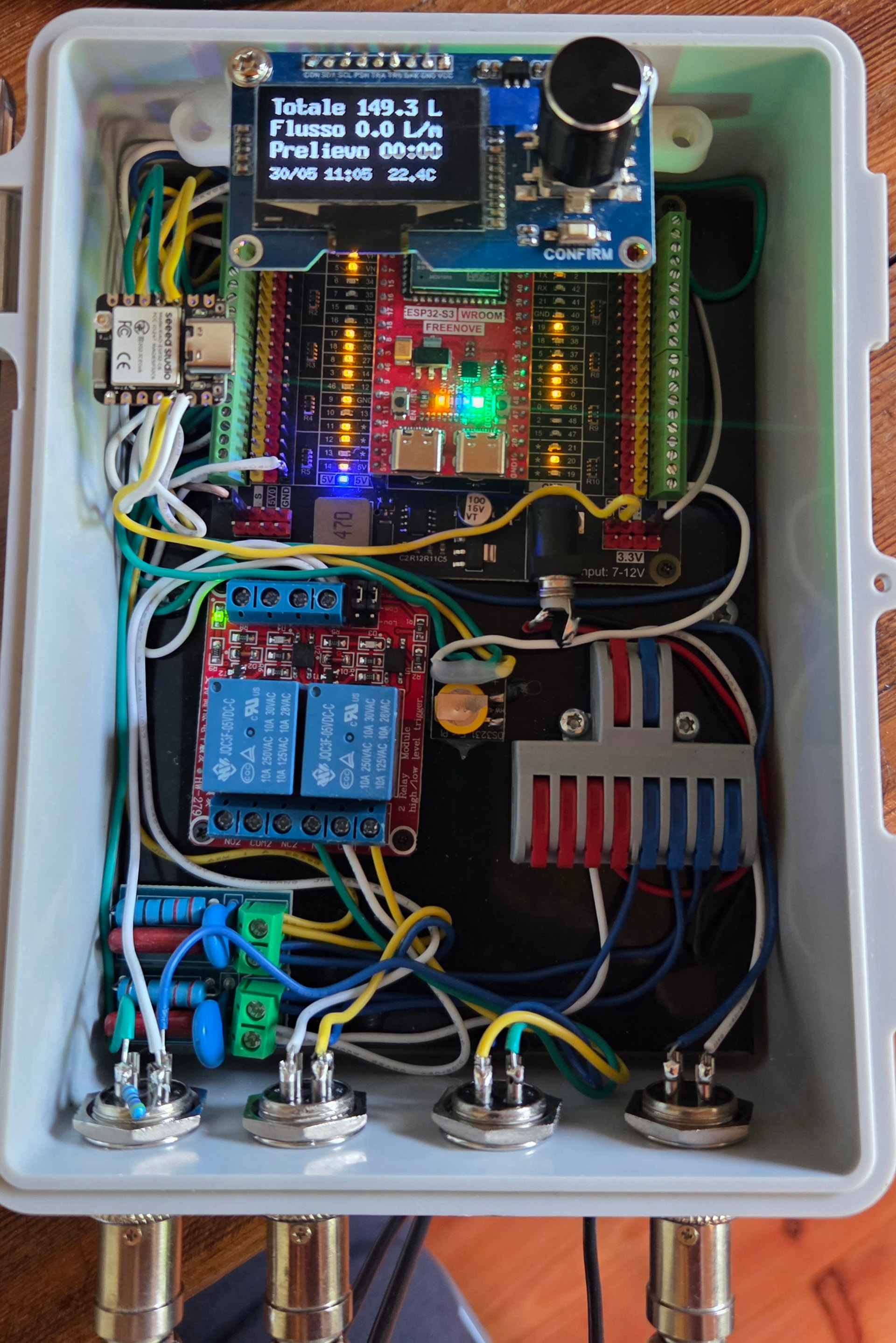

:wrench: WHAT IT DOES

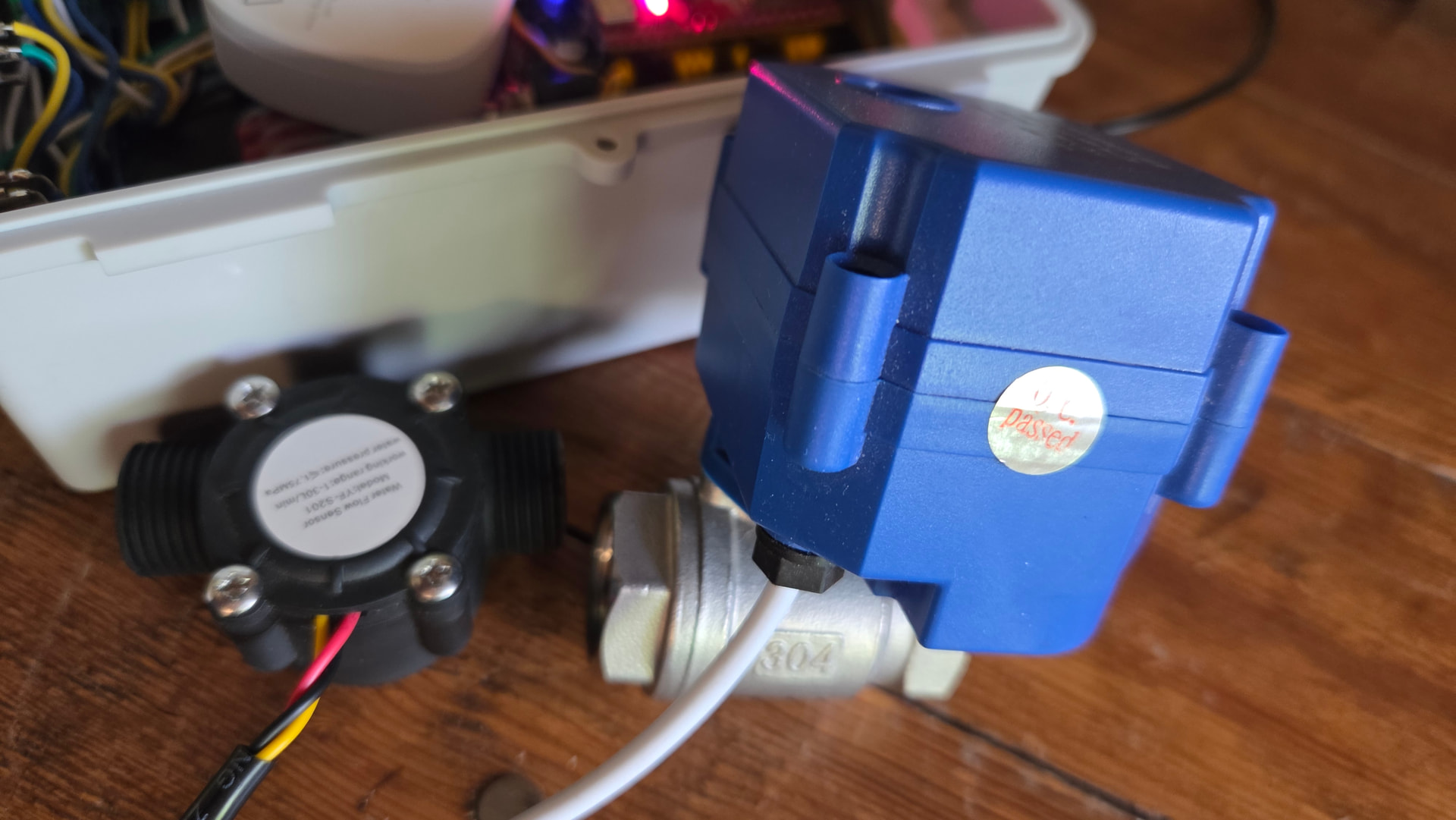

Vergus Virgil monitors your water system
and automatically closes a motorized valve
when it detects an anomaly — in under 50ms.

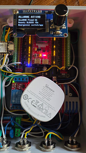

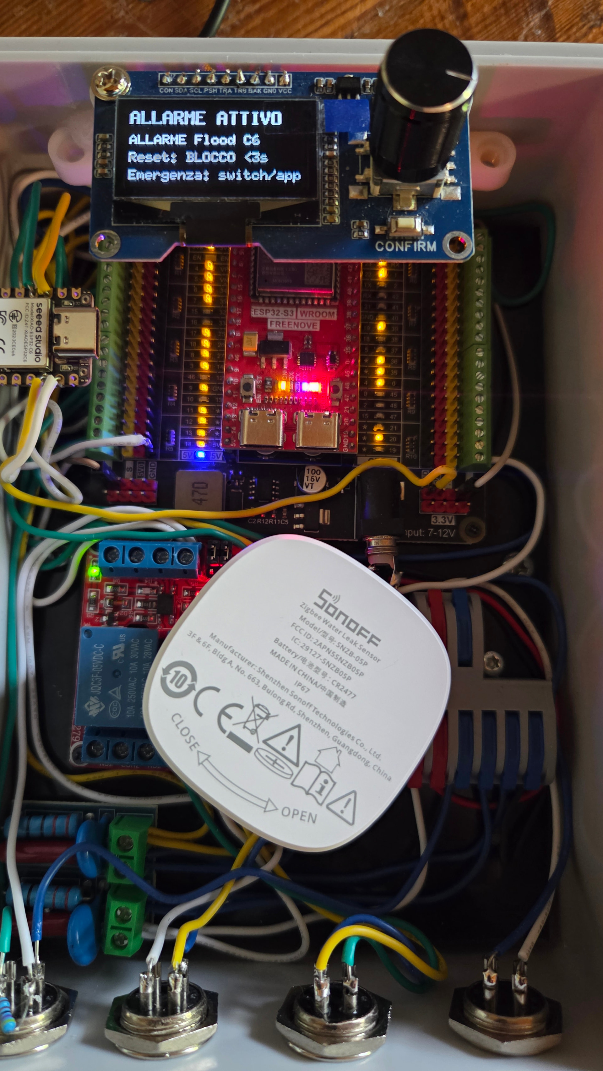

  2. Physical flood sensors
    Native Zigbee coordinator (XIAO ESP32-C6)
    supports SONOFF SNZB-05P, Aqara and any
    Zigbee 3.0 IAS Zone flood sensor
    — no hub, no server,
    no Zigbee2MQTT needed

:gear: TECHNICAL HIGHLIGHTS
  • ESP32-S3 WROOM N16R8 (main controller)
  • XIAO ESP32-C6 (native Zigbee coordinator)
    connected via UART — standalone,
    no external server required
  • FreeRTOS dual-core architecture:
    Core 1: safety tasks (valve < 50ms)
    Core 0: network tasks (Telegram, MQTT)
  • Multi-level watchdog
  • Fail-safe valve (closes on power loss)
  • UPS compatible

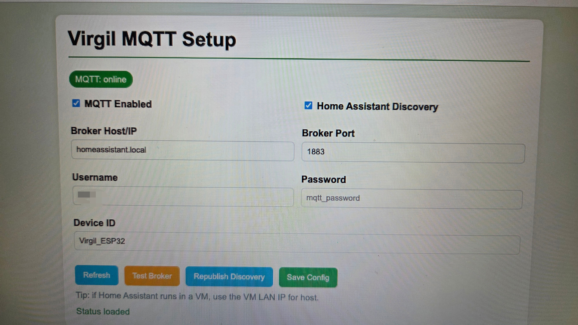

:house: HOME ASSISTANT INTEGRATION
Native MQTT Discovery — zero configuration:
  • Sensors: flow rate, volume, temperature,
    anomaly score
  • Binary sensors: alarm, valve state,
    frost protection
  • Controls: emergency valve, reset alarms
  • Works alongside any existing HA setup

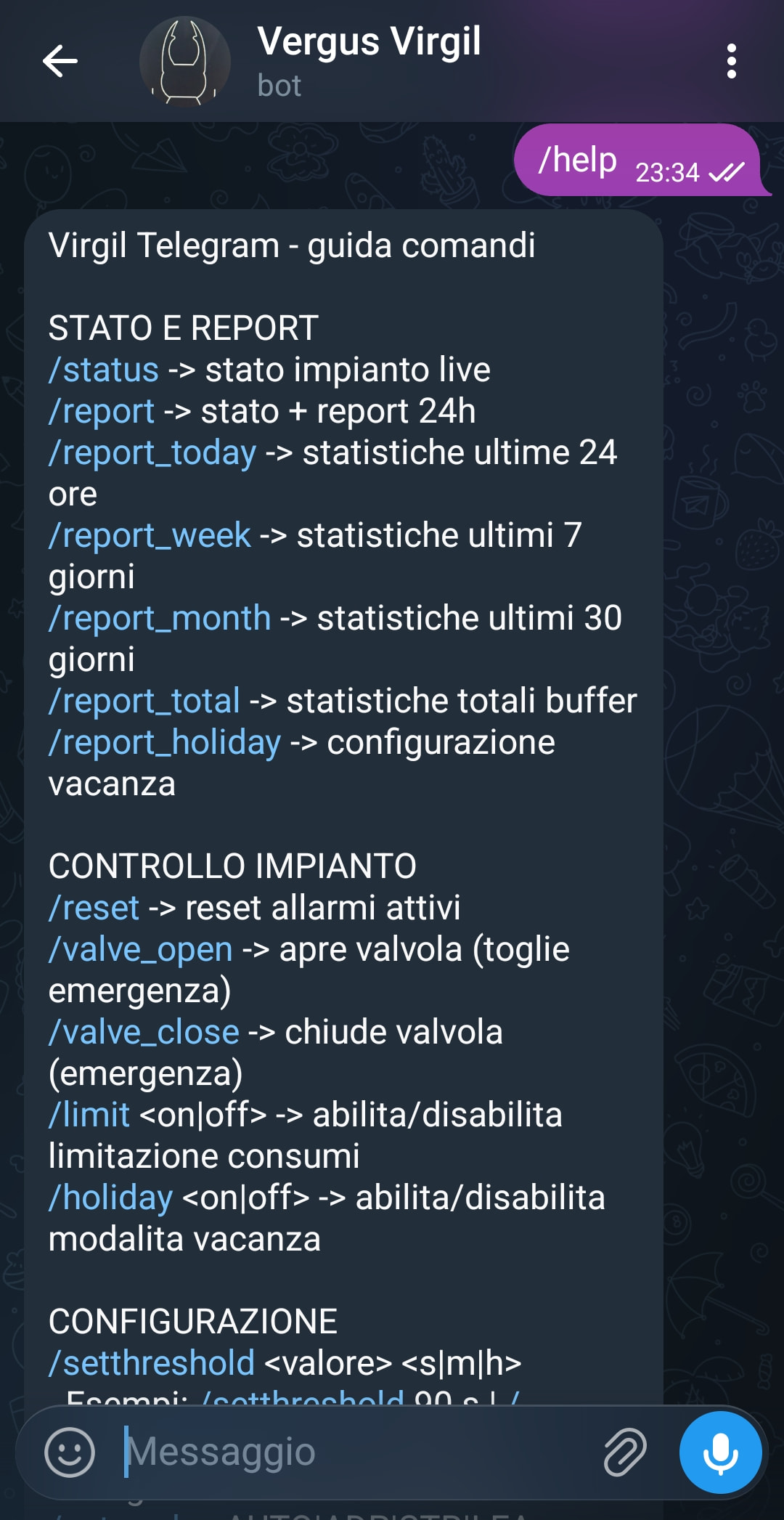

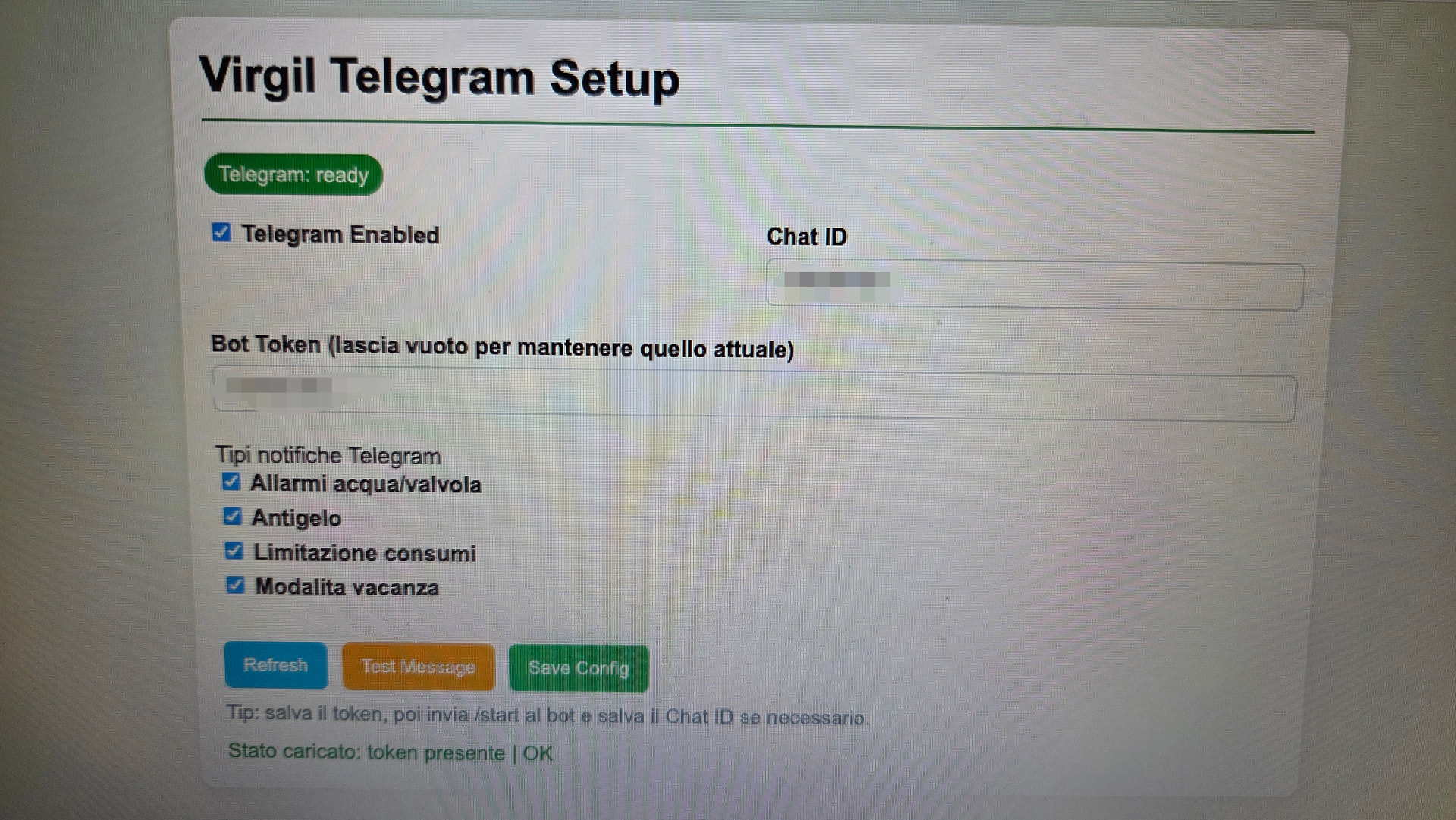

:mobile_phone: TELEGRAM BOT
Full control without HA:
/status — live system status
/report_week — weekly consumption stats
/report_month — monthly consumption stats
/valve_open — open valve manually
/valve_close — close valve (emergency)
/reset — reset active alarms
/zigbee pair — pair new Zigbee sensor
/holiday on|off — vacation mode
/limit on|off — consumption limit

  • Valve anti-blocking automatic cycle
  • Valve fault diagnosis

  • MQTT Setup page via web UI
  • Telegram Setup page via web UI

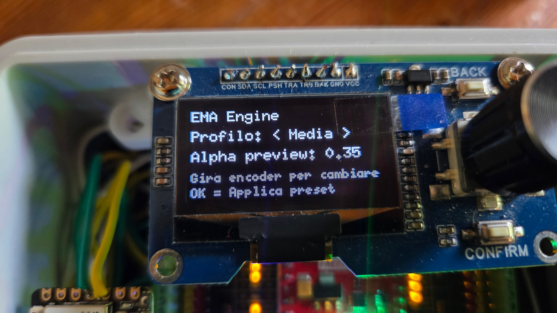

  • EMA Engine sensitivity presets
    (Low / Medium / High + Advanced mode)

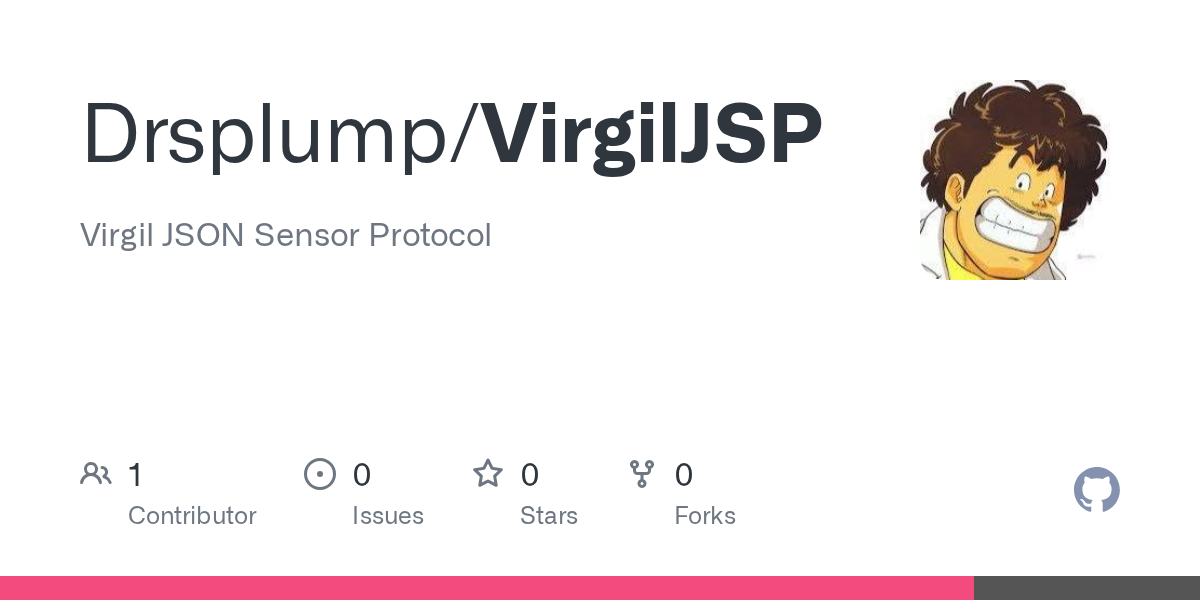

:new_button: UPDATE — VirgilJSP Library Released
I just published VirgilJSP — the open
Arduino library that implements the
Virgil JSON Sensor Protocol.
:package: GitHub:
Any ESP32/ESP8266 can now send JSP
messages to Vergus Virgil in 3 lines:
#include <VirgilJSP.h>
VirgilJSP s("id", "name", "host");
s.sendAlarm(true);
Or build your own JSP hub with
VirgilJSPReceiver.
Compatible with ESPHome, Tasmota,
Shelly Gen4 and any webhook-capable device.

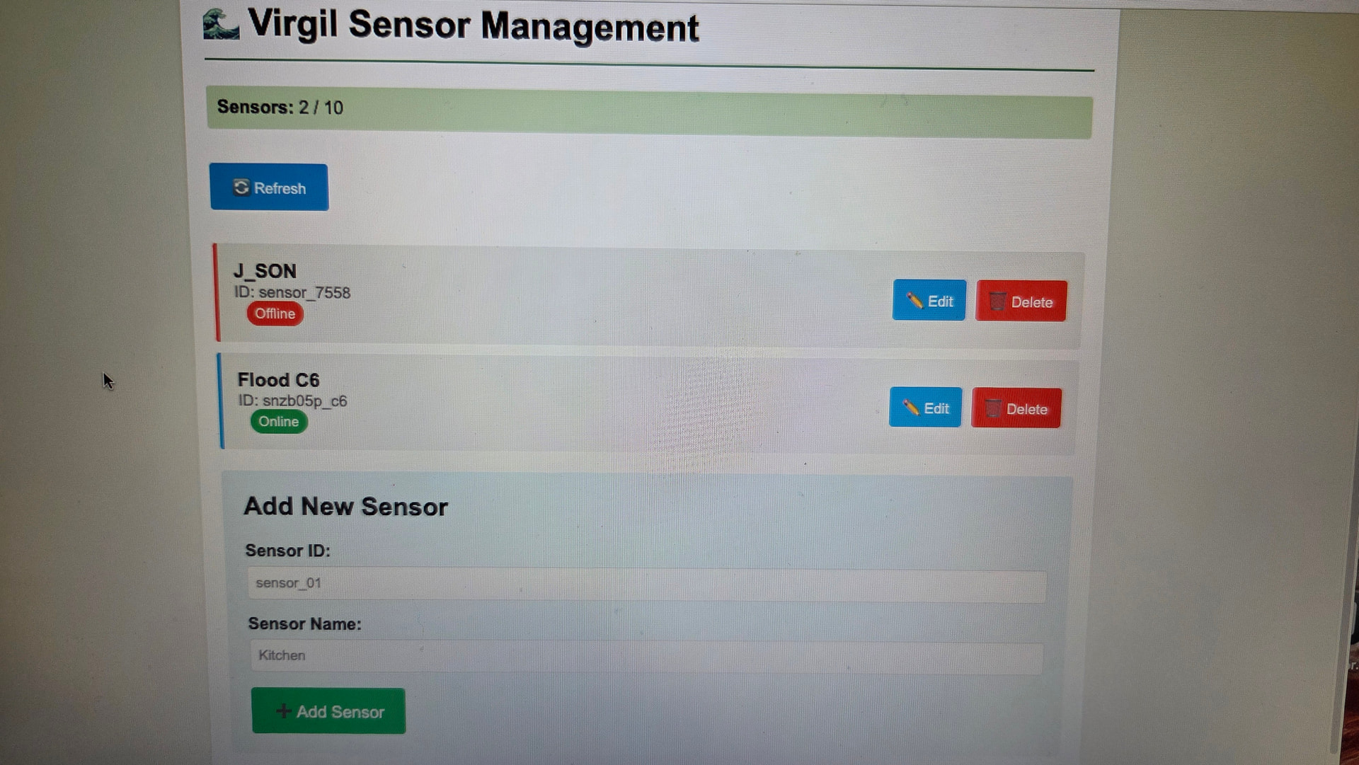

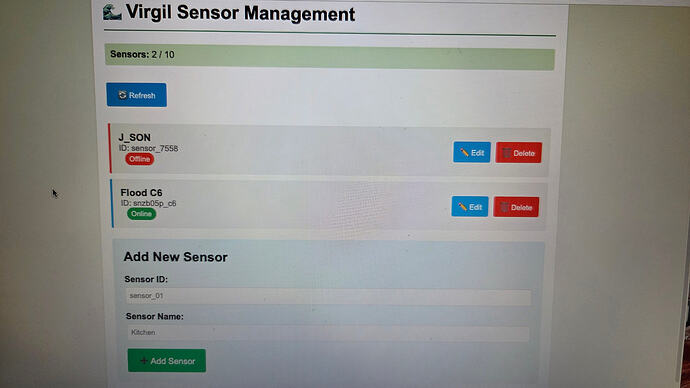

:new_button: UPDATE — Complete Web Dashboard Released
Vergus Virgil now ships with a full
14-page web dashboard — making the
OLED display completely optional.
:bar_chart: Monitoring:
  • Real-time flow, volume, temperature,
    anomaly score
  • Consumption stats (24h/week/month/total)
  • Remote sensors with battery level
  • WiFi / MQTT / Zigbee status
:gear: Full configuration via browser:
  • MQTT broker + HA Discovery
  • Telegram bot setup
  • Sensor management (JSP protocol)
  • Zigbee pairing and device management
  • OTA firmware update
  • Flow parameters & calibration
  • Consumption limits
  • Frost protection
  • Vacation scheduler (7 days × 3 slots)
  • Date/Time with NTP sync
  • EMA Engine presets + advanced tuning
  • Network diagnostics & event log
The dashboard is local-only by design —
all remote control goes through Telegram,
requiring no port forwarding,
no cloud, no subscription.
With 14 configuration pages covering
every aspect of the system, the OLED
becomes optional — enabling a simpler
and more affordable hardware variant.
English translation in progress.
Here are a screenshot below
Built with :heart: — Vergus
