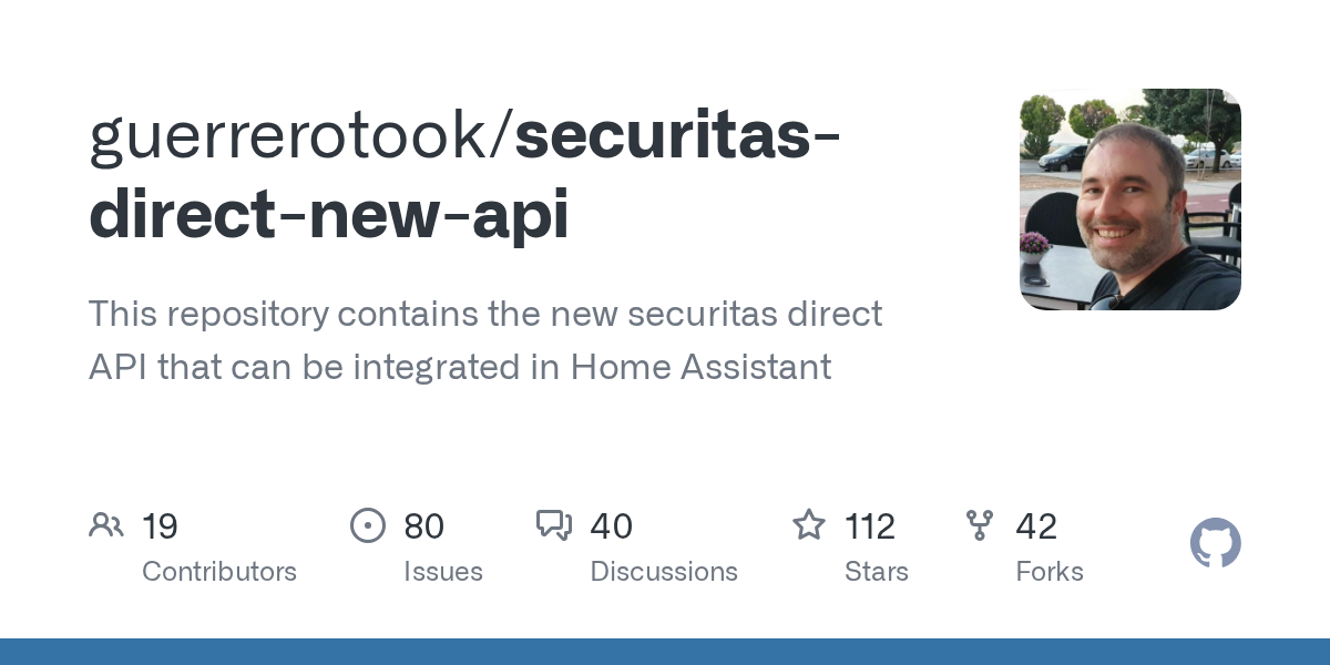

I have Verisure UK connected to Home Assistant - using the Securitas Direct integration.
I can’t remember now how I set it up, but am pretty sure you select a country code in there somewhere, and then go through the usual 2FA process to connect.
System is pretty limited - it reports set status, and you can remotely arm and disarm the alarm
The latest changes are fantastic, everything works like a dream.
