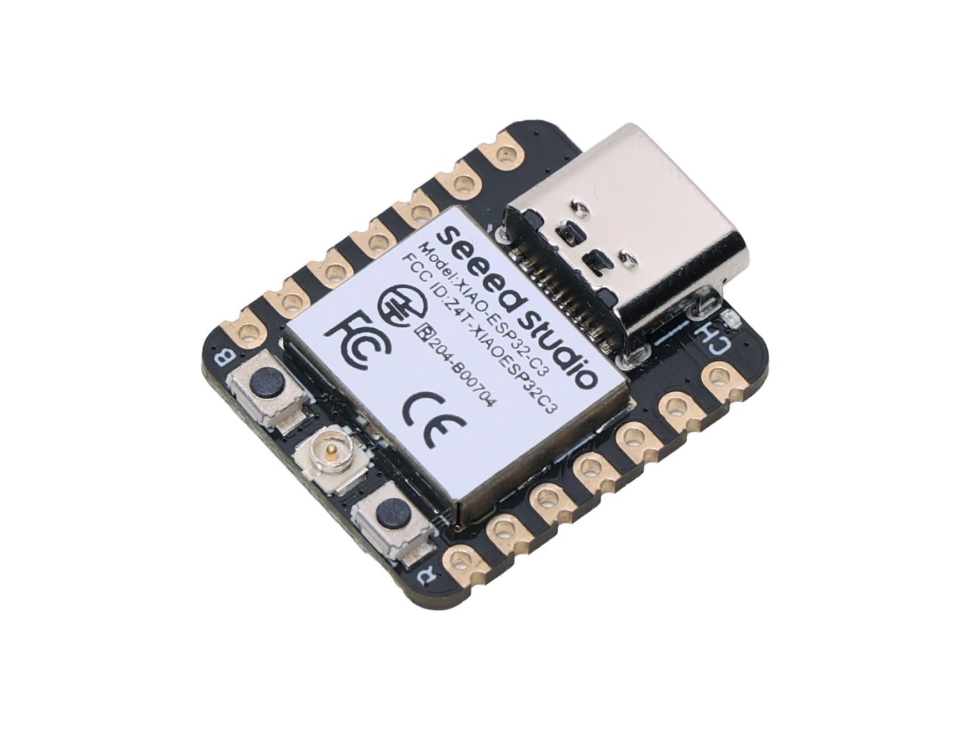

Is it this board?

I know you already figured out your board type, but for next time, this site might come it handy:
https://thelastoutpostworkshop.github.io/ESPConnect/
