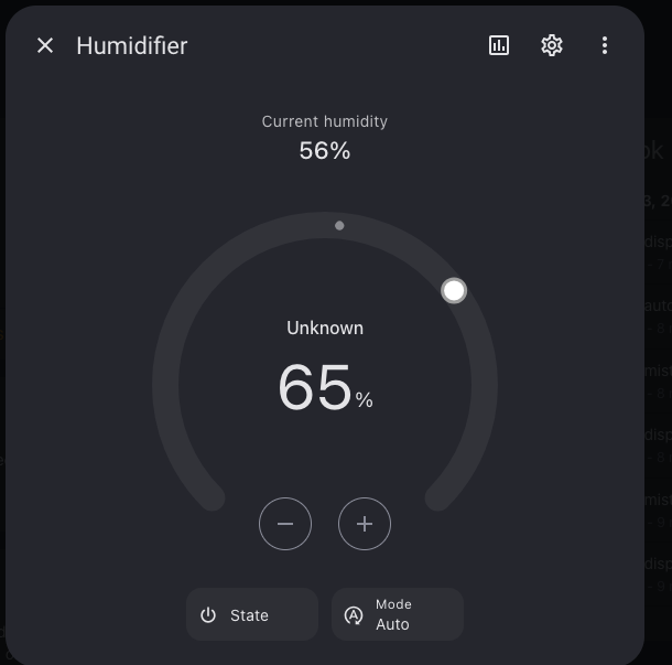

I have the oasismist1000s and used the custom integration, everything seems to be working, kind of slow/glitchy but I guess it’s to expect since it uses the cloud instead of direct connection to the device.
The only issue I have is the state of the humidifier is stuck on unknown, any ways I could modify something in the code to fix this? Where should I look?
Thank you!
