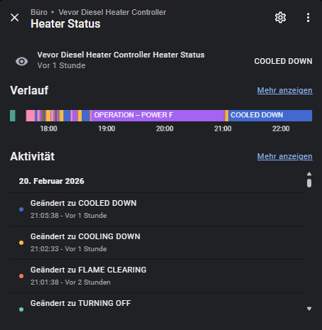

I converted my YAML code to DFxx and can now see the correct status. Furthermore, the heater can be switched on and off with the Turn Heater On button. The Power Toggle (Single cycle) also switches between the different levels.

I wasn't following the thread, sorry. Great, that you have mnaged to communicate with the heater. I use it ocassionally when I work in my garage in the wintertime. I like to check it's status when I'm away or turn it on/off.
