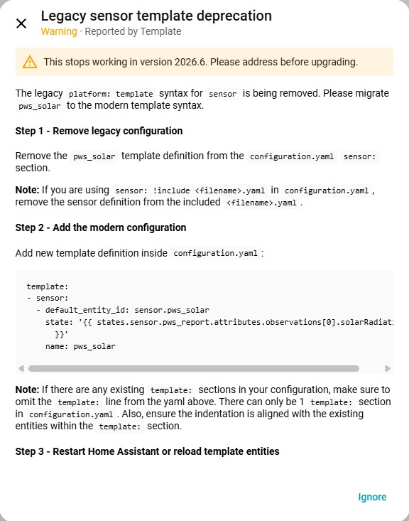

Got 11 ‘fix me messages’ one example is:
I followed all the examples to resolve all 11 errors in my configuration.yaml.

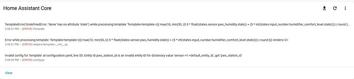

after a reload, the errors went away but I have no data coming into HA from my PWS and getting invalid config message. Any insight is greatly appreciated.
Invalid config msg:

After the suggested fix:
sensor:
- platform: rest
  json_attributes:
    - observations
  value_template: '{{ value_json["observations"][0]["obsTimeLocal"].title() }}'
  resource: !secret wunderground_url
  scan_interval: 300
# For Weather Station
template:
    - sensor:
        - default_entity_id: sensor.pws_location
          state: '{{ states.sensor.pws_report.attributes.observations[0].neighborhood }}'
        - default_entity_id: pws_station_id
          state: '{{ states.sensor.pws_report.attributes.observations[0].stationID }}'
        - default_entity_id: pws_type
          state: '{{ states.sensor.pws_report.attributes.observations[0].softwareType }}'
        - default_entity_id: pws_wind_dir
          name: Wind Direction
          state: '{{ states.sensor.pws_report.attributes.observations[0].winddir }}'
	  unit_of_measurement: "°"
        - default_entity_id: pws_wind_gust
          state: '{{ states.sensor.pws_report.attributes.observations[0].windGust }}'
        - default_entity_id: pws_wind_speed
          state: '{{ states.sensor.pws_report.attributes.observations[0].imperial.windSpeed }}'
          unit_of_measurement: "MPH"
        - default_entity_id: pws_humidity
          state: '{{ states.sensor.pws_report.attributes.observations[0].humidity }}'
          unit_of_measurement: "%"
        - default_entity_id: pws_precip_total
          state: '{{ states.sensor.pws_report.attributes.observations[0].imperial.precipTotal }}'
          unit_of_measurement: "in"
        - default_entity_id: pws_precip_rate
          state: '{{ states.sensor.pws_report.attributes.observations[0].imperial.precipRate }}'
        - default_entity_id: pws_temp
          state: '{{ states.sensor.pws_report.attributes.observations[0].imperial.temp }}'
          unit_of_measurement: °F"
        - default_entity_id: pws_solar
          state: '{{ states.sensor.pws_report.attributes.observations[0].solarRadiation}}'
Please read Petro’s posts in this thread and if you still have questions, ask in that thread…
any fix other than just not updating? i don’t wanna pay $300 to $500 and like the vevor units’s layout.
What are you talking about?
NOT Vevors are very expensive!
But what does the cost have to do with changing a few lines of config?
the config doesn’t work as of 2026 and it’s the only brand i can afford
Yes, it does.
Please take a minute and actually read the repair notices and the deprecation thread linked above. The deprecation of the legacy Template configuration format will not be in full effect for 5 more months.
The deprecation is only about the legacy configuration format of template entities, it will have no effect on your device or its integration. All you need to do is follow the instructions in the thread linked above to update your configuration file. If you use the recommended custom integration to perform the conversion, the task might take you a total of 5-10 minutes.
