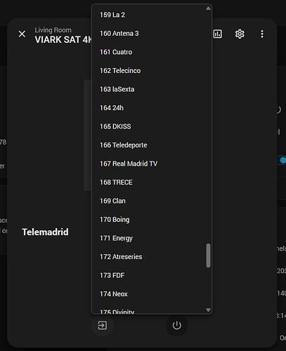

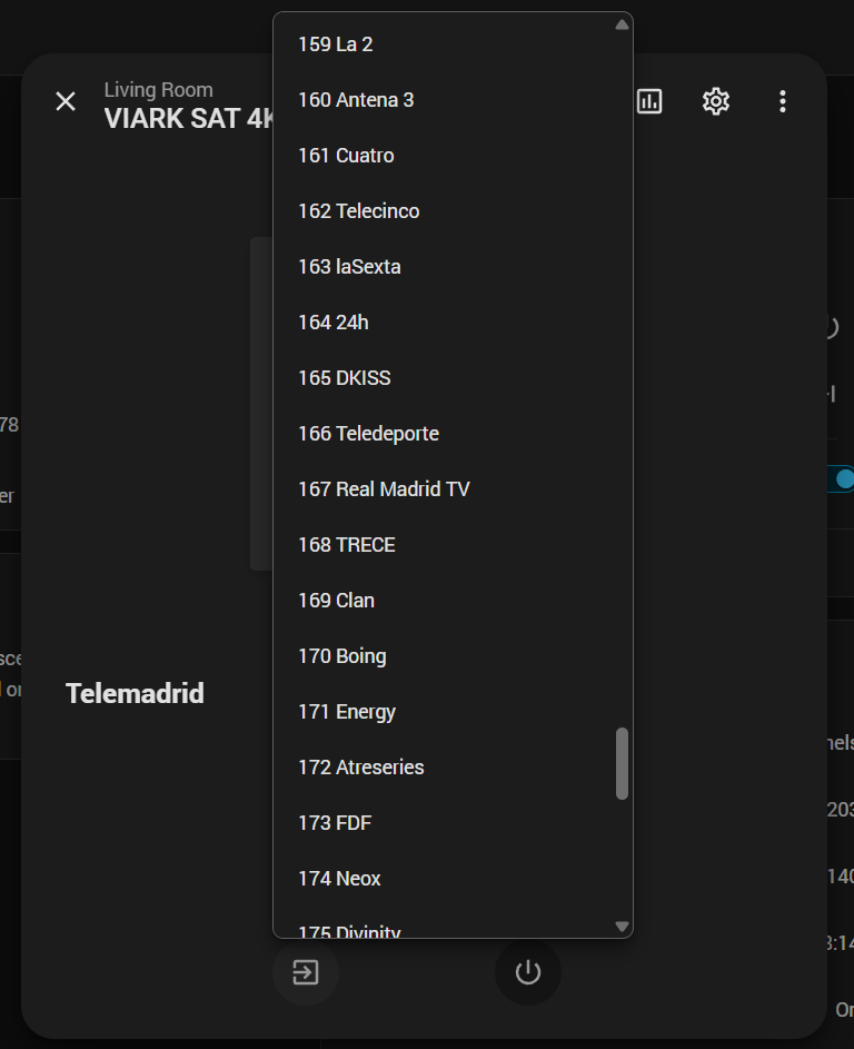

One detail worth calling out: the source dropdown shows channels numbered as the receiver shows them on screen (163 laSexta). Satellite line-ups are full of duplicate channel names, and without the numbers only the first of each was reachable. select_source still accepts a bare name or a bare number, so existing automations don’t need changing.
