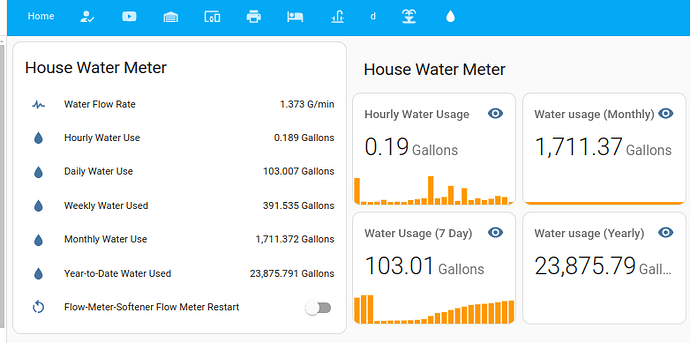

Why not?? Many people including myself installed flow meters on water mains or water branches. I put mine right before it goes into my water softener and it tracks everything the house uses. I have another one on the main line that ffeeds my irrigation and track that water use seperately and have been doing this for 2+ years now. It would be orders of magnitude better and more useful to you than what kind of information you could possibly infer from the use of a vibration sensor on your best day.
It’s actually quite easy to shut off the water, cut a pipe, place a flow meter in that cut section of pipe. They even make push on “Sharkbite” fittings that make it super easy.
