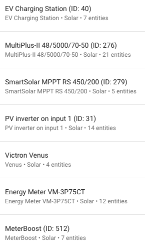

I have 7 devices and 70 entities within this integration:
My setup is a little complex:
  • 3-phase power so 3xMultiPlus-II
  • some “legacy” solar with it’s own inverter on the a/c side of things
  • Batteries
  • An extra energy meter which should be measuring power to / from the grid
Do you have any pointers as to how I should wire this in?
