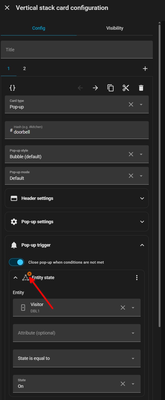

I have noticed when creating the Vertical Stack card there’s an error message and I am wondering if anyone can advise on why this error appears - please see screenshot with the error.
Thanks for reading and I look forward to hearing from someone that might be able to provide a solution to the issue.
That x does not mean something is broken, it just means currently the condition is not met. Is something actually not working as expected? If so, the icon is not the cause.
The vertical stack is just a way to group cards, so if your problem is anywhere, it is with the popup. Is this a custom card?

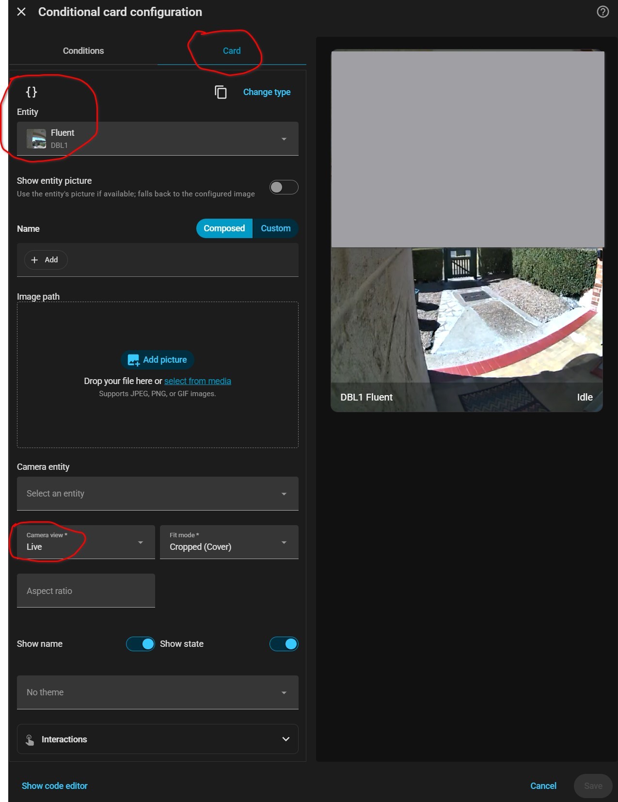

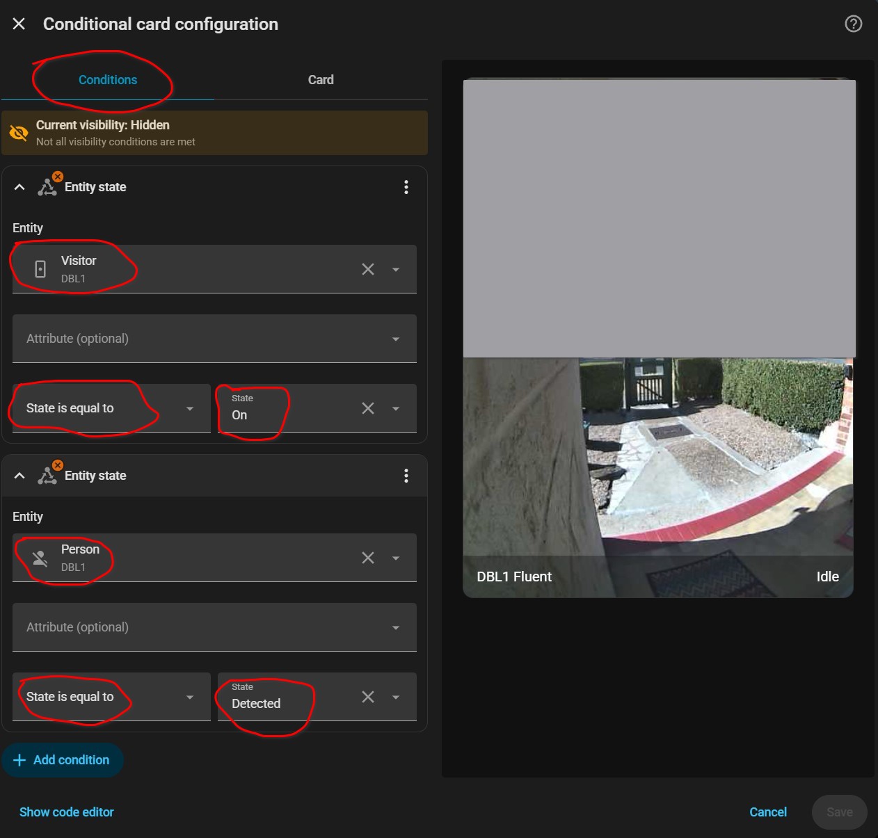

Well a little update. I managed to get it working using, as you suggested a Conditional Card which works perfectly and is so simple to setup (see attached 2 screenshots highlighting the entries I added).
This now, when a person rings the bell, activates a pop up on my Home Assistant dashboard which shows a live video feed from the doorbell.
