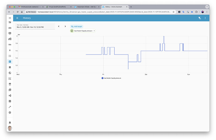

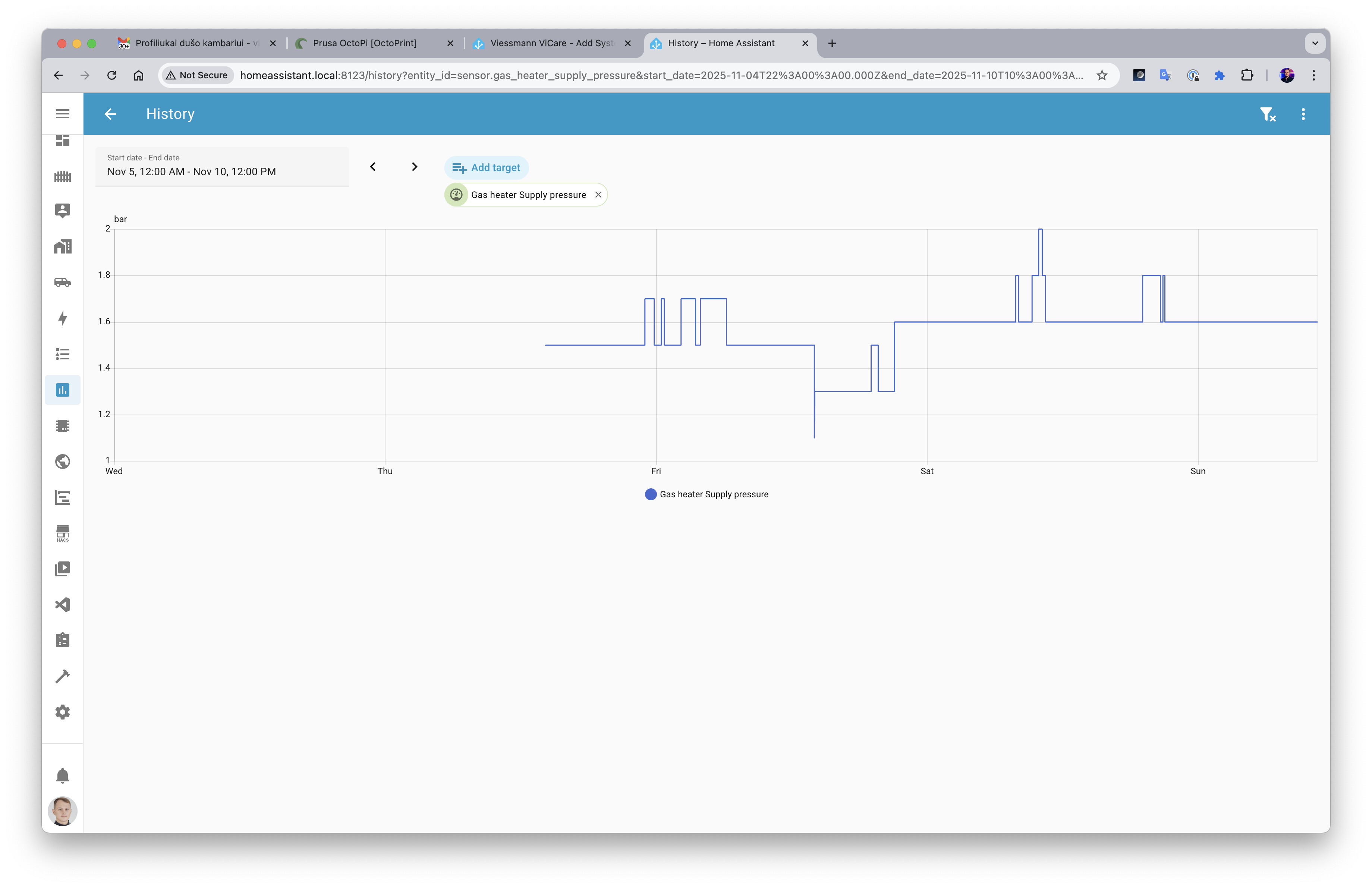

That’s awesome! It finally works! Thanks @Hafenstrand for an update! It appeared on my integration on the November 6th. Here’s how it looks like at my end now:
