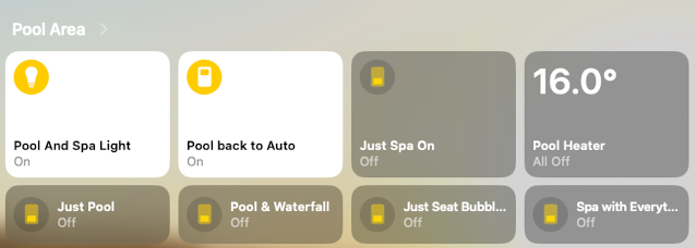

I also struggled with this for a long time especially setting specific pump speeds because the Viron Connect 10 cannot set a specific speed but cycles through them - ChatGPT created a code for me which I can use. But at the moment I have done it in an easier way.
  1. I have home assistant running
  2. I have homebridge running
  3. I created favourites for each execution type on the Connect10 panel and have just exposed these. So in Home Assistant the Favioutes show up and in Apple home they do to.
For example:
  1. Set Pool to Auto (Resets the pool back to auto and timer mode)
  2. Set Spa with Jets (Turns on the spa with jets - config in the Viron is Pool Pump High, Heater On, Spa Jets On.
  3. Set Spa without Jets (Turns on Spa without Jets and just creates a warm hot tub)
Etc…

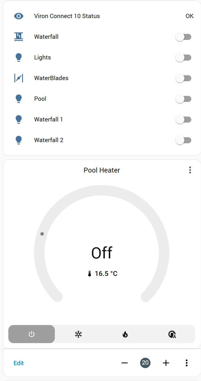

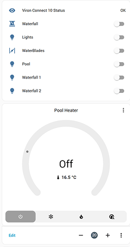

Thanks for the prompt. After I fed some infor to chat GPT i managed to build a custom component in HAS. It works perfectly!!
