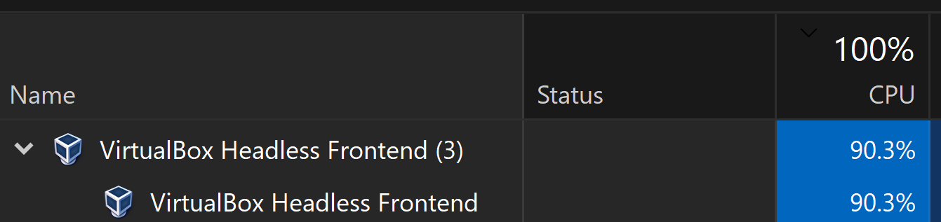

Behavior on Host PC: CPU usage will be pegged at 100% until I open the Virtual Machine and then it will drop to 30-50%, sometimes this alone will fix the issue. Everything else seems nominal. If HAOS does not recover by opening the VM through VirtualBox, I will shut down the VM and restart it within VirtualBox (I run the VM in headless most of the time).

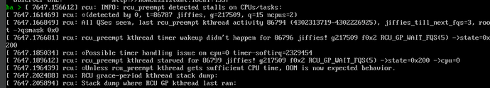

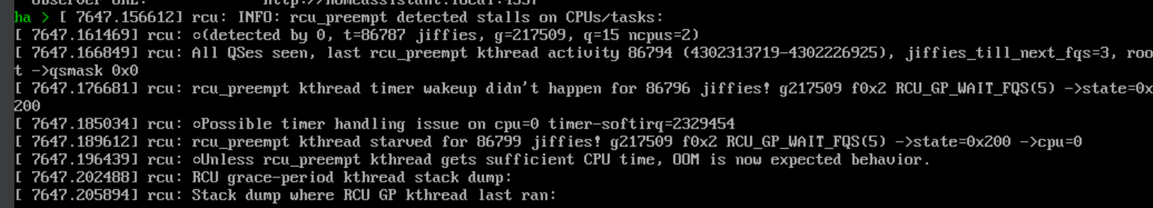

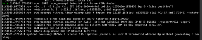

I sometimes see errors on the VM CLI, the screenshot below is an example, but I dont know much about the error or how to troubleshoot it…

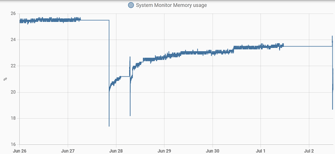

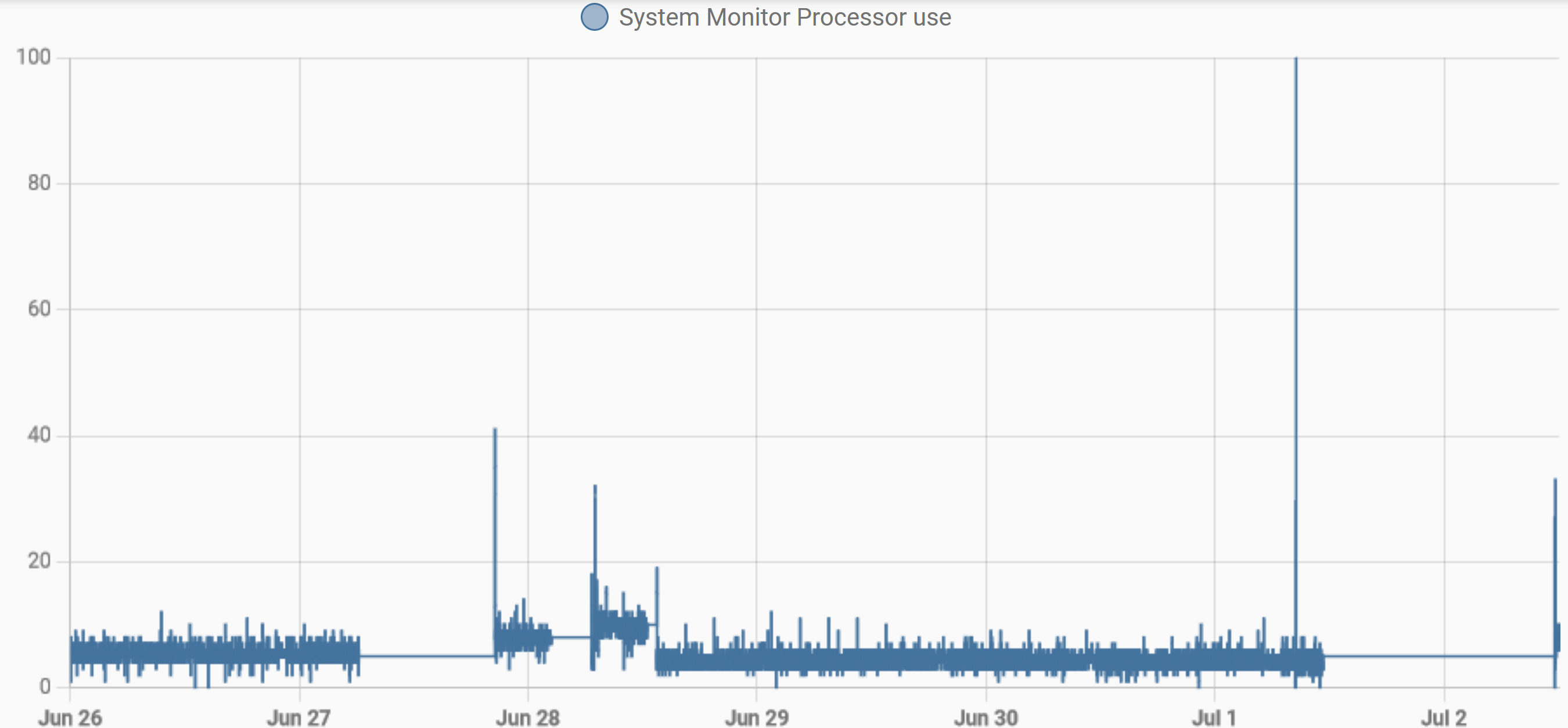

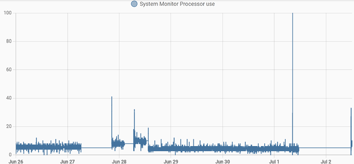

I installed system monitor hoping to see something there but the CPU and memory usage within home assistant seem fine. it is weird to me that the cpu usage on the Windows is much higher than what HAOS indicates it is using.

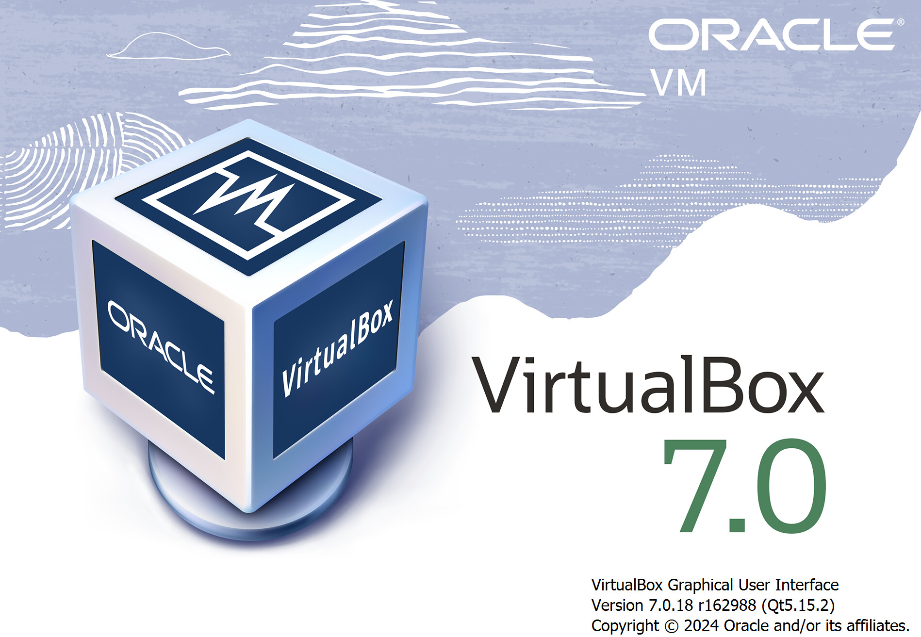

VirtualBox Version: 7.0.18

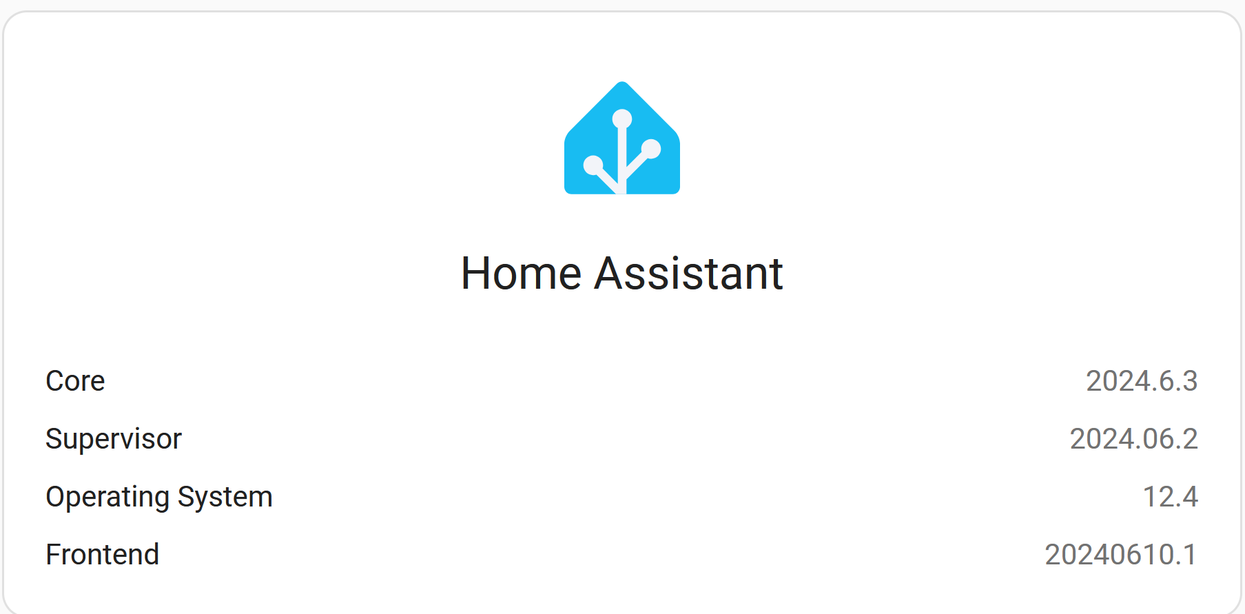

HAOS Version: 2024.6.3

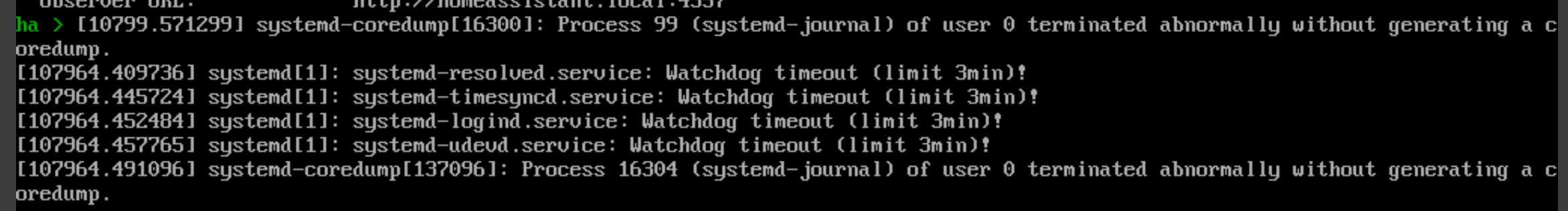

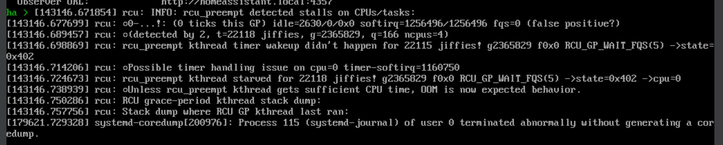

No crashes in the past 7hrs while at work, but did see this in the HAOS CLI log:
So whatever the root cause is still present, but now it doesn’t cause HA to become unresponsive which is a step in the right direction for sure.
The only error I see in HA is the following from this morning, thinking they are unrelated though…

Been running for 8-9 days now and everything seems stable enough! Will look at logs tonight and see if there are any issues. Then slowly start enabling features to ensure its all good!
