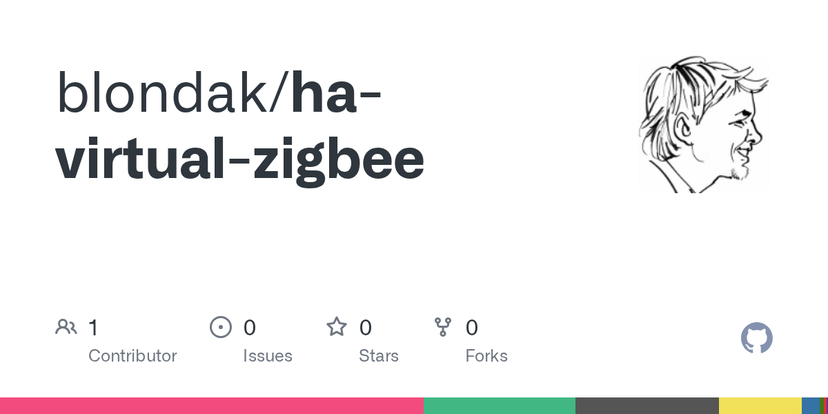

The project is currently an early working prototype rather than a finished consumer product. The firmware, web interface, documentation and build instructions are available under the MIT license.
GitHub:

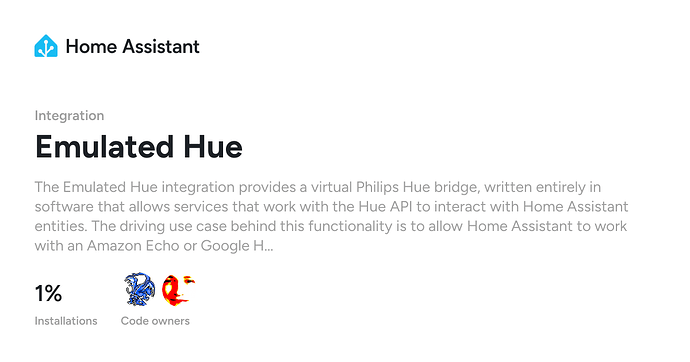

Isn’t that something which should work out of the box with the Hue simulator?
