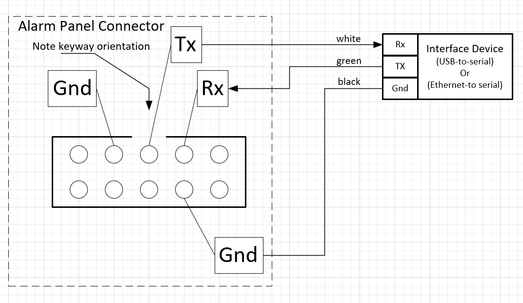

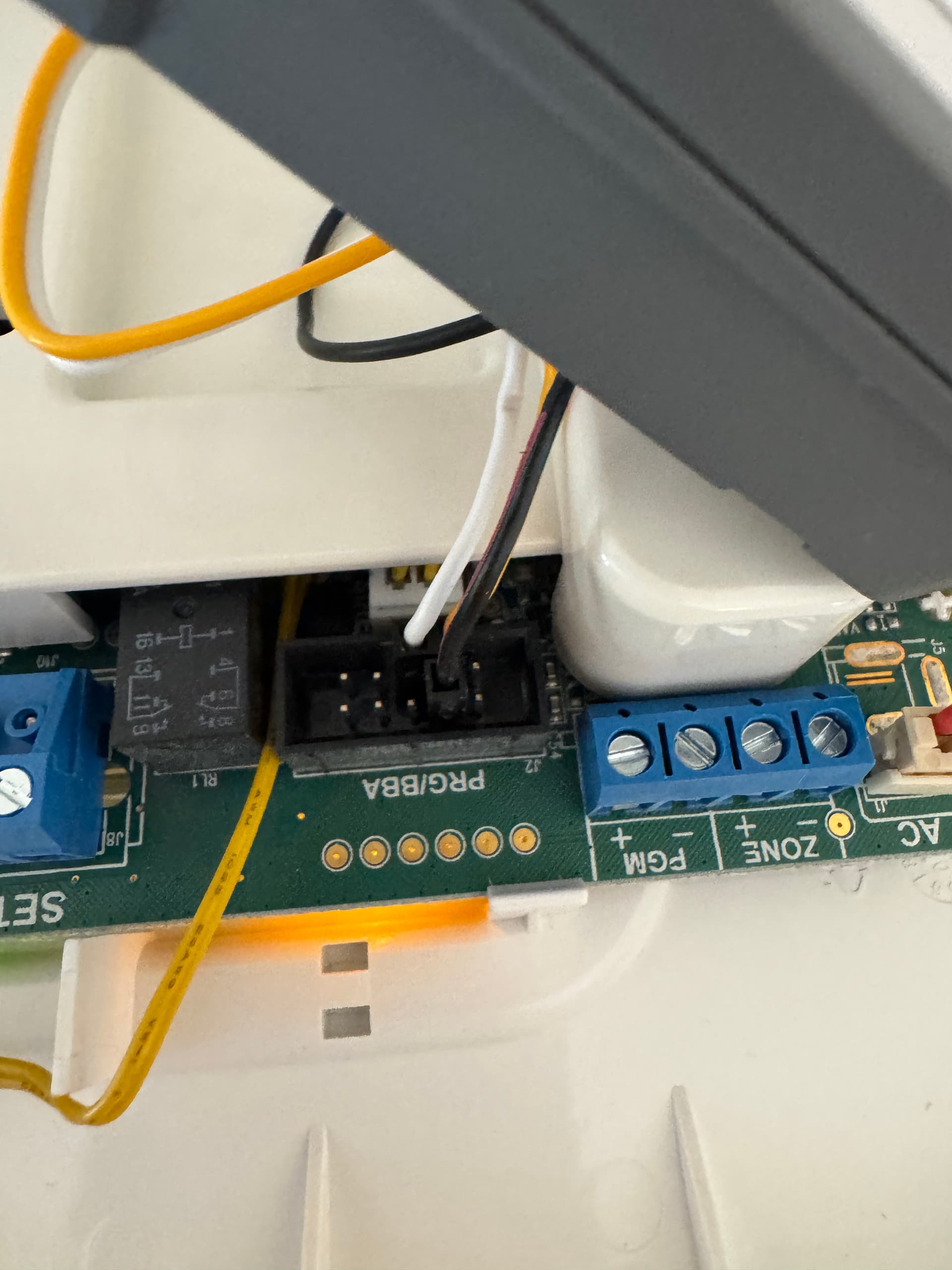

Hello all, i know this question has been asked a lot but i just would like for someone to verify i plugged my esp 32 poe correctly to my powermaster 10, at least then i know to focus on my integration which is still showing the alarm as unavailable
coming from the esp the cables are
black in ground
yellow is tx
white is rx
It depends how you define Tx and Rx. Just to be clear, here’s a drawing.
